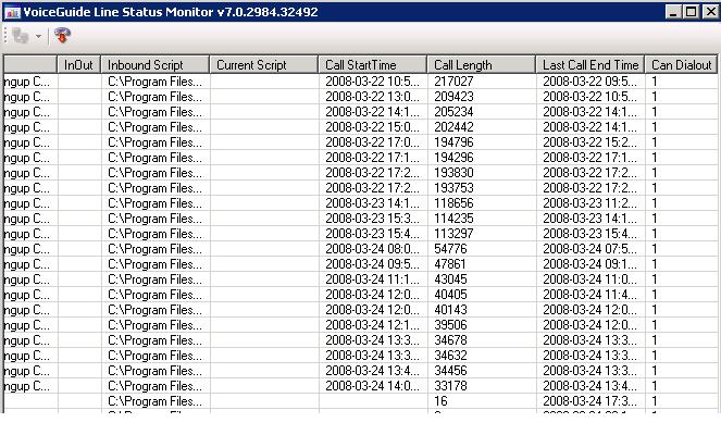

I also noticed that my line status monitor is still trying to hang up line 1 - its been an hour. Can you please look at this too.

Plus, its not hanging up the lines properly. In the Line Status Monitor Application it shows that I have two lines in use one with 9000 seconds and counting. This was an old problem with VG7 which adam fixed in 7.03.

Since upgrading to V7.05 - I have starting seeing a new problem. I have a script which connects a caller with an out side operator.
If the caller drops the call no problem. If the call is hung up on line two it does not alls drop the call. I have attached a print screen of three lines which are still held open as well as the log files. If it helps, when I first start VG the first couple call - don't go through. Throughout the day the number of lines which are not freed up grow.

Regarding the lines not hanging up: Can you provide access to this machine using www.logmein.com? If yes then please email login details to suport@voiceguide.com and include a link to this forum thread in the email.
