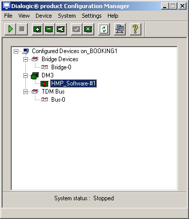

I'm having a little trouble getting HMP up and running for VoIP

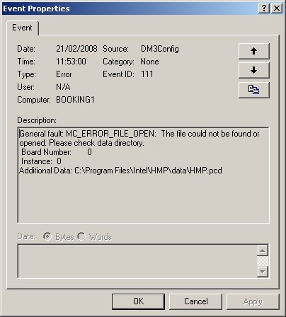

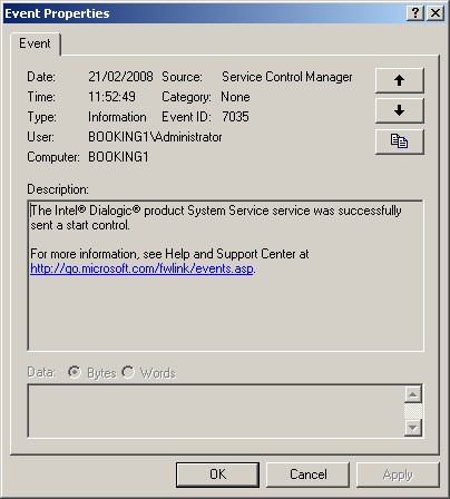

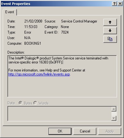

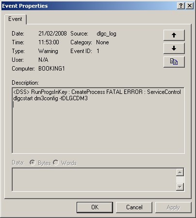

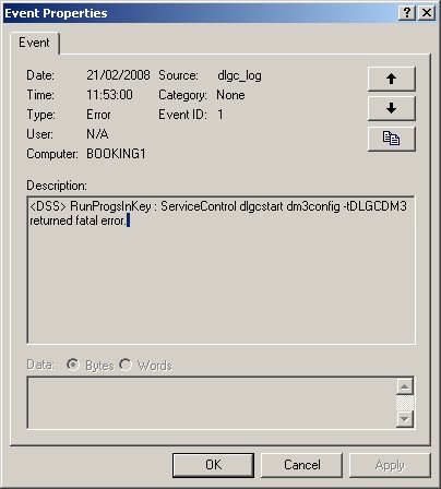

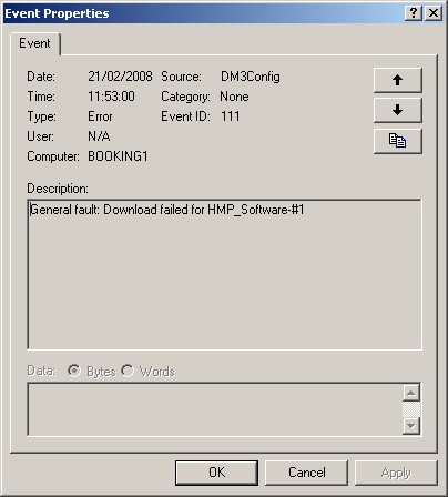

I get a number of errors (attached) when trying to start the service. The HMP 'device' is recognised in Device Manager. The service temporarily starts then immediately stops with errors.

We get the exact same problem on other machines as well. Can you walk us through what steps you take when installing HMP? We just install the core runtime package. No devices are detected and we add HMP software manually in the configuration manager. Are we doing something wrong?

That is very strange. When we do this, no devices are automatically started. The service cannot be started through the configuration manager as it complains that there are no devices.
