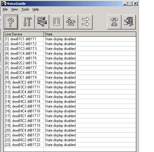

Clarification of original post - Status Guide application is running in VoiceGuide version 6.0.3349 Enterprise.
Status monitor is displaying 'State display disabled' for all lines as indicated in attached GIF.
How do we enable status monitoring to display status of PRI channels on Dialogic D/240JCT-T1 card? <_<
The screen shot you attached shows the VoiceGuide v6 application itself, not the Status Monitor application.
Look in the Start->Programs->VoiceGuide menu for the application called Status Monitor, or look for application called vgStatusMonitor.exe in VoiceGuide's home directory (usually C:\Program Files\VoiceGuide)
