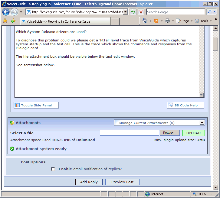

To diagnose this problem could we please get a 'ktTel' level trace from VoiceGuide which captures system startup and the test call. This is the trace which shows the commands and responses from the Dialogic card.
The file attachment box should be visible below the text edit window.
See screenshot below:
E1 card is D300/JCT
