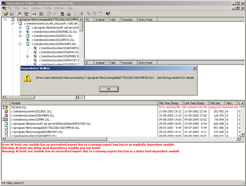

Dependency Walker reports several errors. I attached the .txt file it generates and a screenshot.

Screenshot shows that the following DLLs are missing on your system:
LIBGC.DLL
NCMAPI.DLL
MPR.DLL
The lack of LIBGC.DLL indicates that you did not install the Global Call protocols on your system. Global Call protocols must be installed. They are installed automatically in SR6.0, but on SR5.x you need to install them separately.
Please reinstall the Dialogic System Release drivers and ensure that Global Call is selected when you install. Also install the Global Call protocol pack.
