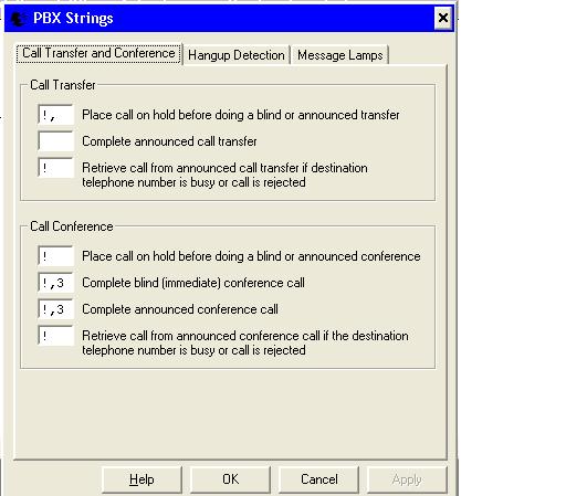

I'm exeriencing strange behaviour of VG for Dialogic with Dialogic 4 ports card. I'm trying to transfer a call to some local number, the transfer goes ok & I can hear answering machine speaking on another number, but once VG hangs up, I start hear intercept (ciren) tone instead of answering machine.
At the same time if I won't wait till VG hangs up and just press "hang up" in the window, everything works fine - VG will waiting for the call again & I will be listening to answering machine.
Does anybody have ideas what is the problem?
I forgot to say that the phone system I'm using is called Avaya Definity G3i
Maybe it can help you in understanding the problem.
Please post traces capturing the entire call if VG completes the transfer.
What are the "PBX Strings" set to?

Trace shows that VG issued a hookflash, then dialeed the number and then hung up.
Is that the way that transfers are usually performed on this PBX?
How do you do manual trasnfers usually?
