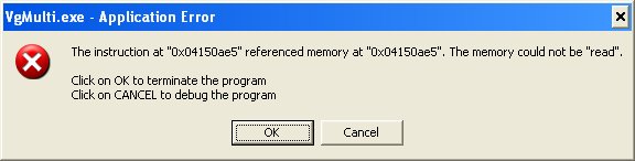

Application Error
Every time I close VoiceGuide I get an error
Screen shot attached.
Log follows

Any thoughts or comments?
Which version of Dialogic System Release drivers are you using?
If v5.1.1 then have you installed the Service Pack 1 or the Feature Pack 1?
