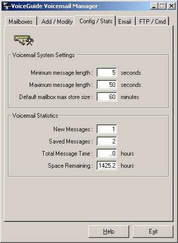

The Max and Min message lengths can be set using the Voicemail Manager - these settings are available for editing in the 'Config' tab of that program:
The issue that halnet reported was a bit different though - and I suspect that it's caused either by false busy tone detections or that the silence detection level is set too high for the modem/card that is used - and recordings are stopped after silence is mistakenly detected... if we had a copy of VoiceGuide's Debug Printout which captures the problem, this would allow us to see what is happening...
