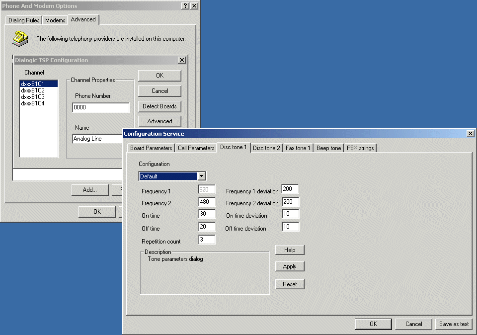

Once you know the frequencies and the on/off times you can edit the Dialogic's TAPI TSP configuration. See:
1. Open "Control Panel -> Phone and Modem Options",
2. Go to "Advanced" Tab
3. Bring up the "Dialogic Service Provider"
4. Click "Advanced"
5. Go to "Disc Tone 1" tab
(above works for Win2000)
