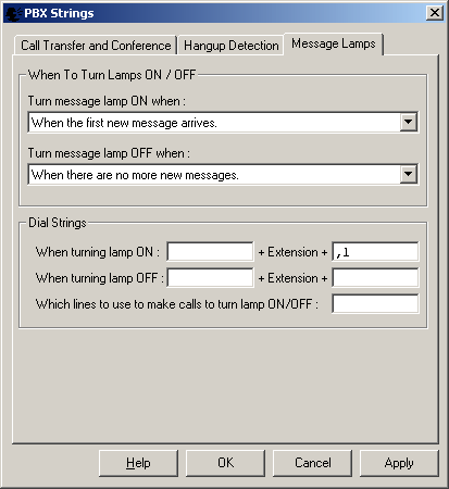

Have just had an idea, when I call an extn, and while that extn is ringing, I hit "1" the call terminates and the MW lamp on the called extn is activated. (as per normal callback message).
I didnt realise before but if the extn you call is diverted to another extn, pressing "1" still activates the original called extn no's light.
Can this senario be utilized by VoiceGuides message wait function?
i.e leave the pre dial box blank & insert ",,1" in the post dial box?? (,, to add a pause after the extn no is dialled)
If this will work then all our problems are solved & will purchase a VoiceGuide 4 line enterprise edition.
Sounds like you should config your PBX Strings like the attached image.
You can try using just "1" instead of ",1"
Yes. But one comma should probably be enough (if needed at all).
I guess that some other key (2?) would be used to turn the message lamp off...
You will need Dialer add-on as well. See: http://www.voiceguide.com/vgFeatures.htm
