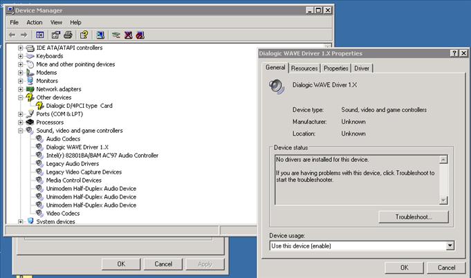

I am running on a Dell 360 Precision 2.0 gHz 512 Meg Ram. My problem is when I try to start VoiceGuide it says that "Wave Driver Not Installed". However, I have followed the instructions as provided and it is installed on the machine. I have even tried uninstalling everything and re-installing to no avail. I am running WinXP with latest service packs and have run Intel® Dialogic® System Release 5.1.1 FP1 for Windows®
Please help.
D/4PCI Just completed fresh OS, Driver, VoiceGuide install. Tested with TALKER32 and everything appears to be working in order until I start the AutoDialer. Then each line says "Wave Driver not installed". Image is too large to upload, but will work to get you a screenshot.

If you keep having problems with the Wave drivers send an email to sales@voiceguide.com asking for "VG for Dialogic" - that version does not use the Wave drivers at all but sends sound files to the Dialogic card directly.
