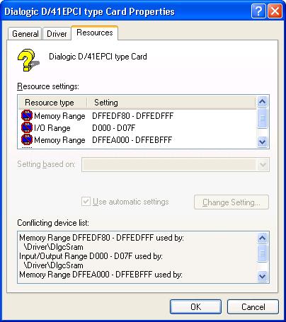

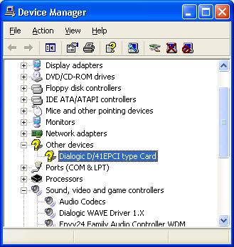

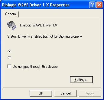

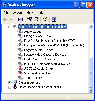

Here are a few screen shots.
Note that the Dialogic Device itself is showing in device manager as 'Other Devices', and its properties/resources shows that it conflicts with another device (which is the same device: it is conflicting with itslef) so I do not think that is an issue.
Note also that I have a load of audio/vidoe drivers (are all audio drivers are Wave drivers? How to tell). I also have a capture card. I tried disabling them (but not deleteing) but it still did not help.
The WAVE driver says it is not working properly. How to fix that?
