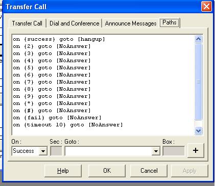

5. I attached to you picture for transfer module settings hwcih is announced transfer.
The problem is when I set the time out of the transfer module is 20 the system does detect the busy or not available

If it is ringing then it looks like the ringback signal is mistaken by the Dialogic card for the busy tone. Can you record the ring back that is heard, or do you know the frequencies and cadence of the ringback tone? You will need to modify the busy/disconnect tone settings in the Dialogic’s config.
Both of the previous traces where made when the system just timed out awaiting for the recipient of call to answer. Do you have any traces of a transfer when the 'extension is busy' was reported?
