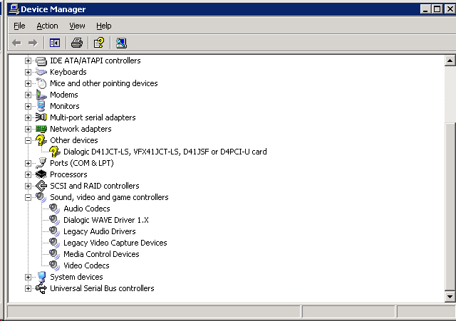

Can you please post screenshots from the Windows' Device Manager and the 'Sounds and Multimedia' applets from the Control Panel - the same ones that are shown in the installation instructions.
I'm not sure how to post screen shots to the forum. So, I'm attaching them one at a time.

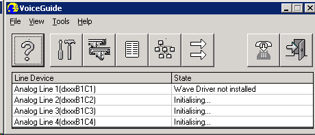

I noticed something peculiar. When clicking on "Settings" button of the first attachment, I am unable to see the "Dialogic Wave Driver Configuration" window. Also see this attached screen. This is what I see when I start Voiceguide.

The screenshots show that the configuration appears all fine, but the trace shows that Windows responds with an error when VoiceGuide calls the windows function to retrieve a handle to the wave drivers installed for the Dialogic card...
As all config looks OK, it's not obvious what's causing this on the Windows' side.
