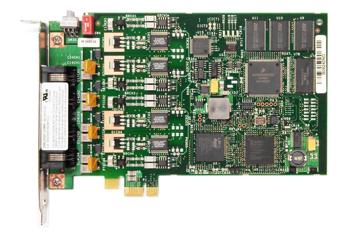

Note that a lot of sellers on Ebay etc. get the photos wrong by reusing one standard photo of a 'short' card over and over. You need to look at the card model tag itself, and it's best to just contact seller to confirm what they actually have.
Below is one photo of a D/4PCI series card that has a PCIe interface:
Screenshot 2026-08-09 at 08-52-34 d4pciufeq.png (PNG Image 1000 × 1000 pixels).png
The latest drivers available on our website should work ( DialogicSR_for_VoiceGuide_276.zip ).
