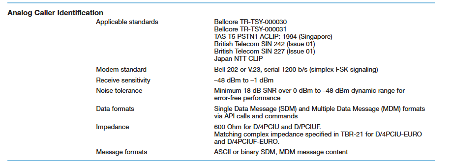

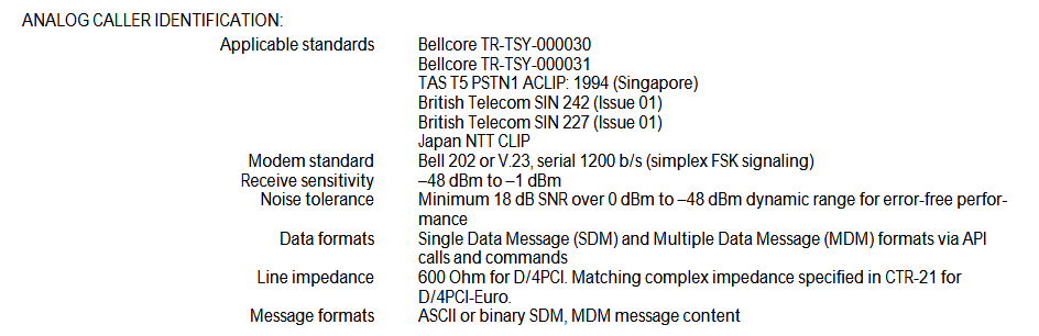

D/4PCI supports:

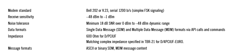

Which is same as D/4PCIU and D/4PCIUF:

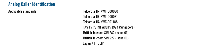

But looks like later versions of D/4PCIUF then support additional standard:
so maybe your D/4PCI cards in your backup system do not support the CallerID standard sent by telco on your lines? Hard to say as the D/4PCI cards are quite old.
