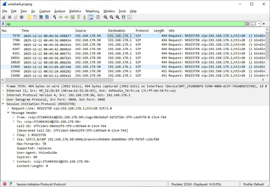

WireShark trace shows that the REGISTER messages sent from HMP are not even replied to.

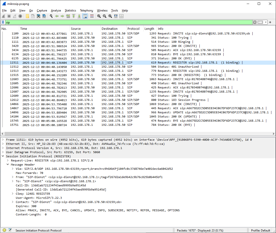

Can you please post a WireShark capture of a working MicroSIP registration and the subsequent call connection?

In this capture file you should see a successful registration with two phone calls, one in and one out.
mikrosip.pcapng
You would need to ask makers of "AVM FritzBox7490" as to why their device does not respond to SIP REGISTER messages issued to them from Dialogic HMP.
Maybe that device is configured to only accept SIP REGISTER from certain extension names/numbers? (sip-dienst@192.168.178.1 ?)
