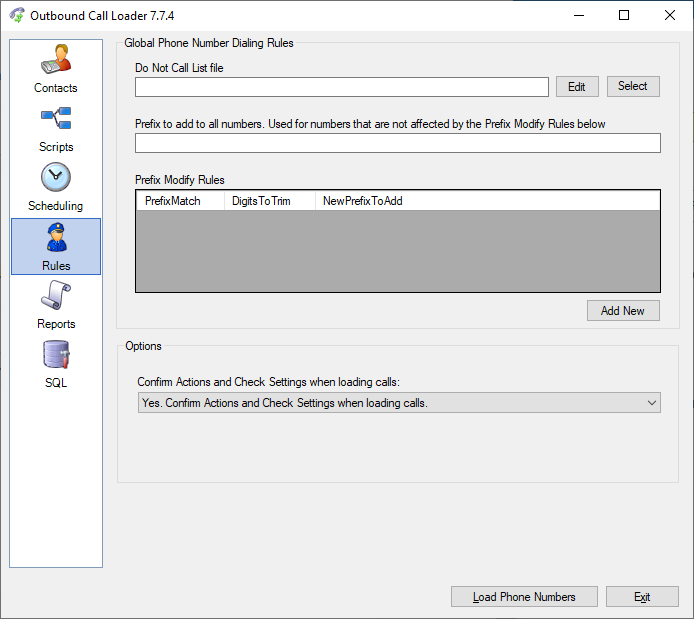

The prefixes added to the loading numbers can be set on the "Rules" tab of the Outbound Call Loader app:

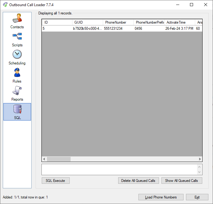

After loading the numbers but before the loaded numbers start being dialed you can retrieve the prefix used for each number from VoiceGuide's internal database callque table.
callque table has a column PhoneNumberPrefix that stores the prefix.
More information on the database used by the callque table can be found here: https://www.voiceguide.com/vghelp/source/html/dial_vgdb_external_config.htm
The contents of the callque table can also be seen using the "SQL" tab of the Outbound Call Loader app:
