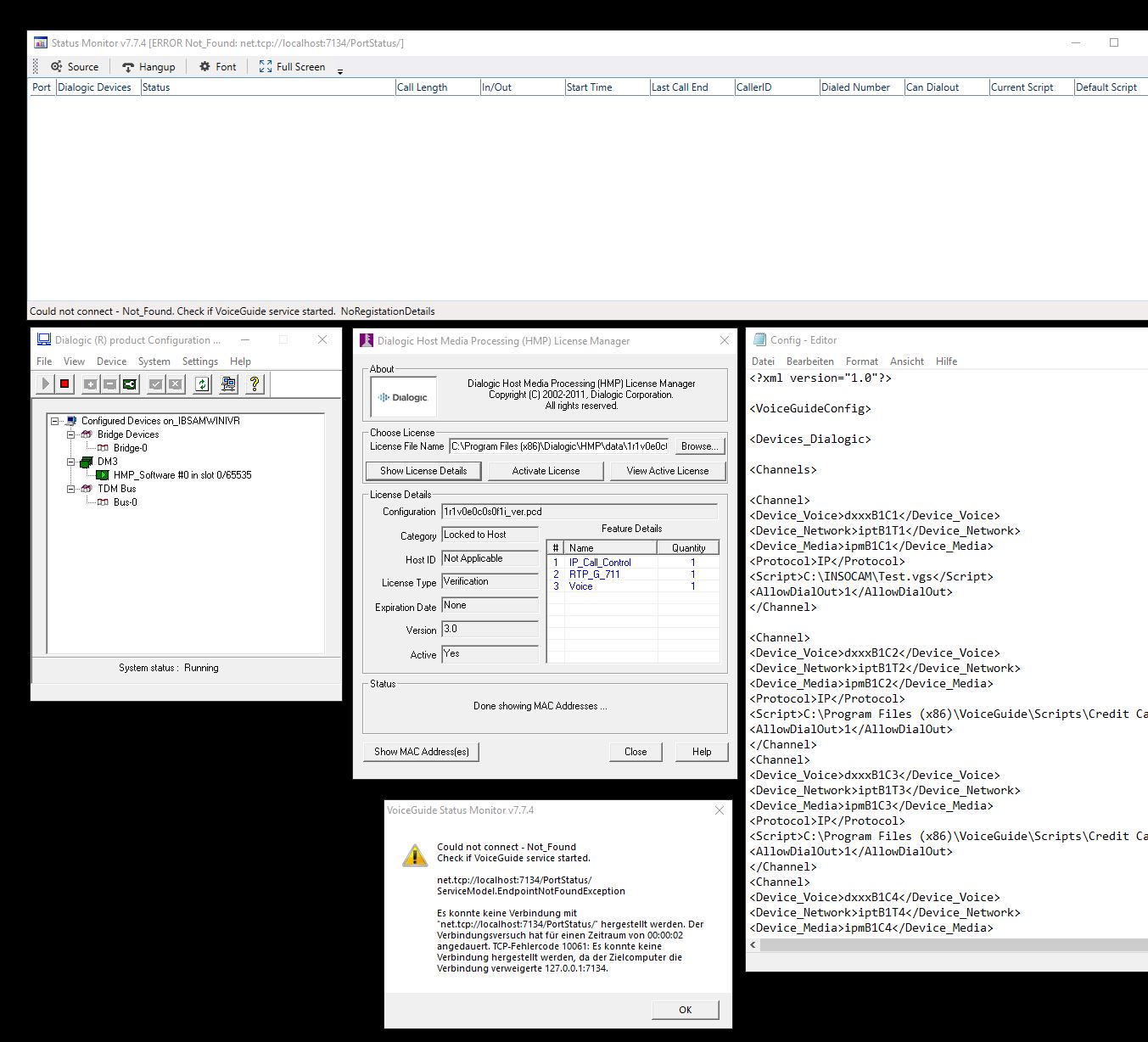

I try to install a VG test version according to the instructions but no line is found.
See pictures
What is wrong?
Kind regards
Frank Schwarz

Hello,
the VoiceGuide Service is not started and the IVR icon is red (service is stopped).
When we try to start the service, we get the error "service could not be started. Erro 0xfffffff6".

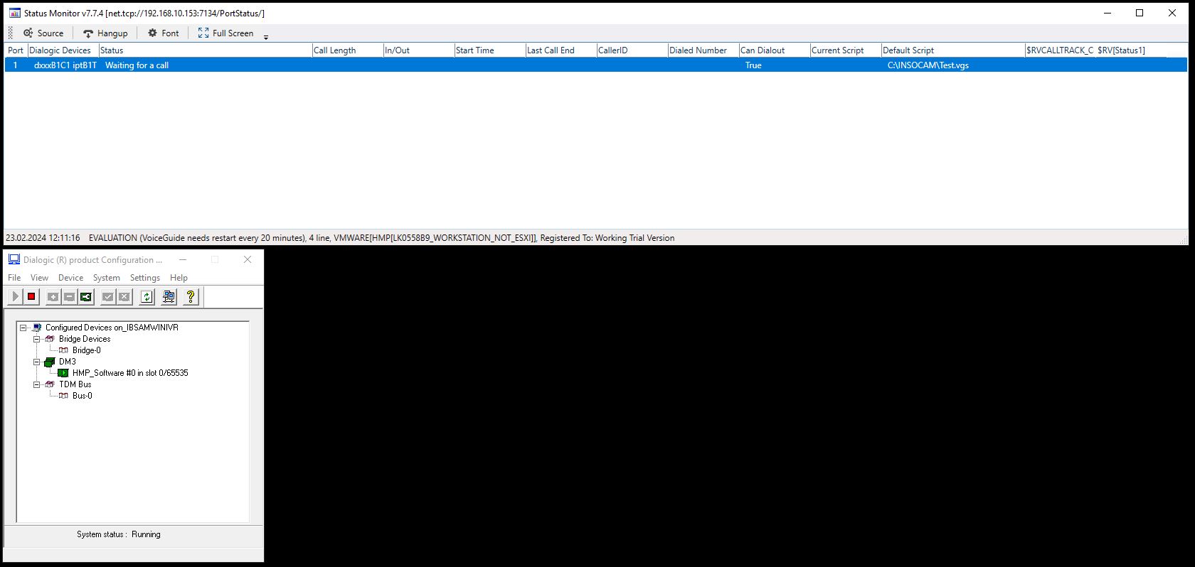

We can see that you are now using HMP Service Update 540.
Not sure why SU548 would not start on this VMware system when SU540 started ok. Guess that's a question to Dialogic.
For purposes of testing which SU does start on your VMware system you could just download any HMP version direct from Dialogic. Current latest is SU556. Pretty much all of the basic features will work in VoiceGuide regardless of which Service Update version of HMP you have installed.
We can see that you are now trying to register a SIP extension with a PBX or similar. If you continue having issues in getting this working please start a new thread on that topic.
