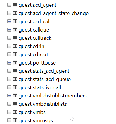

We have noticed today one of our guests' SQL databases that is connected to VoiceGuide has "guest" schema with some VG internal tables created under it.
Since we are using SQL DB, we have created and been using the main tables, such as cdrin, cdrout and portouse etc, under dbo schema in SQL Server, and did not expect VG to create its own tables under our database.

1. Is this configurable to make VG NOT create the schema and tables on its own in our database (so that we continue using SQL database without having those VG-creted tables)?
2. If we delete those tables, schema and user "guest" created from the SQL DB, will VoiceGuide still function without any issues? (It seems VG is still using our tables under "dbo" schema)

VoiceGuide will create all the necessary Tables/Indexes/etc the first time it uses the user specified database.
As per above: if a Connect string has been set  in VoiceGuide's Config.xml specifying the database VoiceGuide should be using instead of VoiceGuide's default local SQLite file, then VoiceGuide will create in that user-specified database the tables that VoiceGuide needs.

Since what version of VG did it start creating those tables under SQL server? (We've been using VG more than 15 years now, and you know it did not do that before.)
We have been distributing this version (7.6.42) for most of our customers and noticed some of the SQL databases still do not have VG-created tables.
Is there some kind of setting that enables/disables creations of those tables under SQL Server? We are trying to resolve this duplicate table issue (in two different schemas) if possible and continue using the tables we have added to "dbo" schema.
