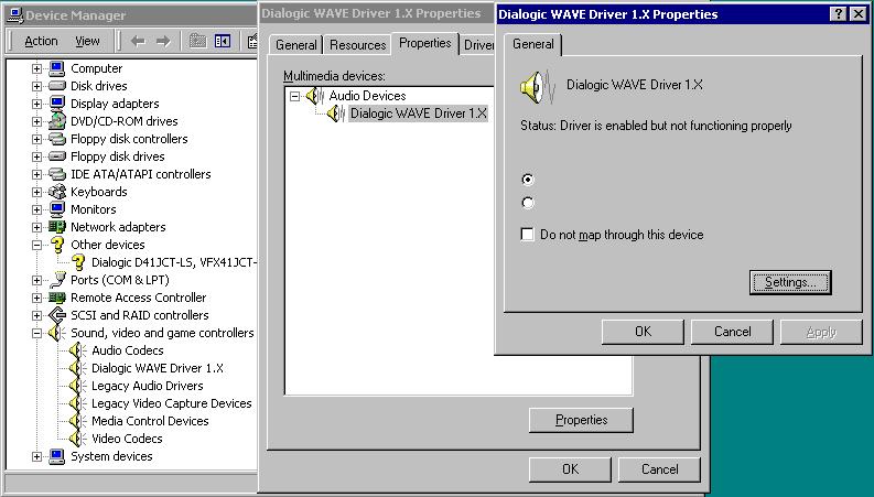

The card is recognized under Windows, driver is installed. Installation of TAPI is successfull (boards are detected). DCM starts automatically. The problem occurs during installation of WAVE driver. When I try to access properties of if I get the message "Status: Driver is enabled but not functioning properly". There are also two radio buttons without description on that screen. I get the same results when using SR SP1 and SR FP1. The installation was done according to manual.

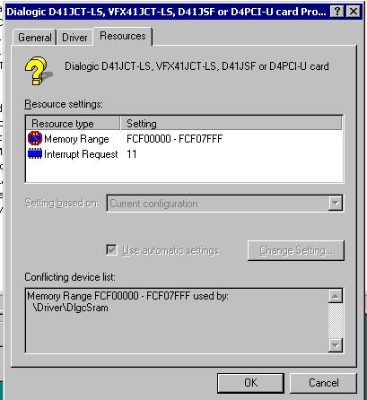

1. When I look at "resources" of Dialogic driver there is some problem (conflict) with memory mapping - I see following message:
Memory Range FCF00000-FCF07FFF used by: \Driver\DlgcSram

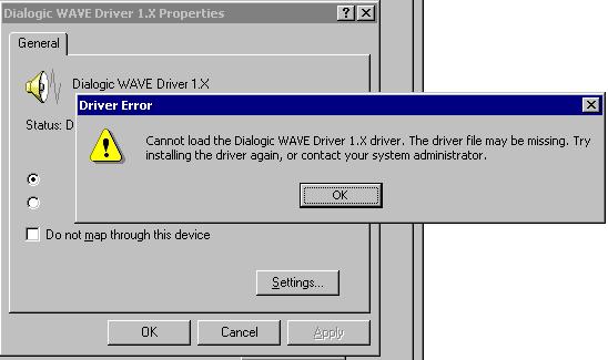

When I try to access settings I get "Driver Error" with message:
Cannot load the Dialogic WAVE Driver 1.X driver. The driver file may be missing. Try installing the driver again, or contact your system administrator.

Could you please post a screenshot of this, showing the error and the contents of the "Sounds and Multimedia Properties" window.

In situations where there are memory conflicts reported in the Device Manager the usual approach is to start disabling other devices on the computer - like 'games ports', network adapters etc - usually you can find what is causing the memory conflict...
What is the "Remote Access Controller"? Can you try disabling/uninstalling that as well?
When using D/4PCIU we usually install SR5.1.1 + SR5.1.1FP1 - and the default memory selected just works - mind you the card initially comes up as a "PCI Device" with an Exclamation mark over it - but TAPI/Wave drivers still work OK...
I'd try disabling all you can on the system, running the entire install again... this is the only thing that I can suggest as I really cannot deduce what precisely is responsible here...
