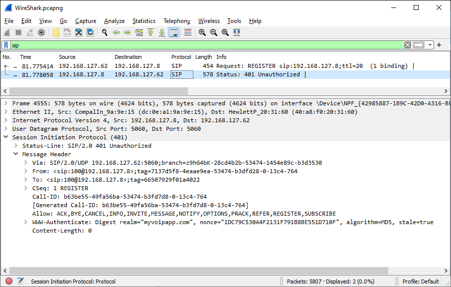

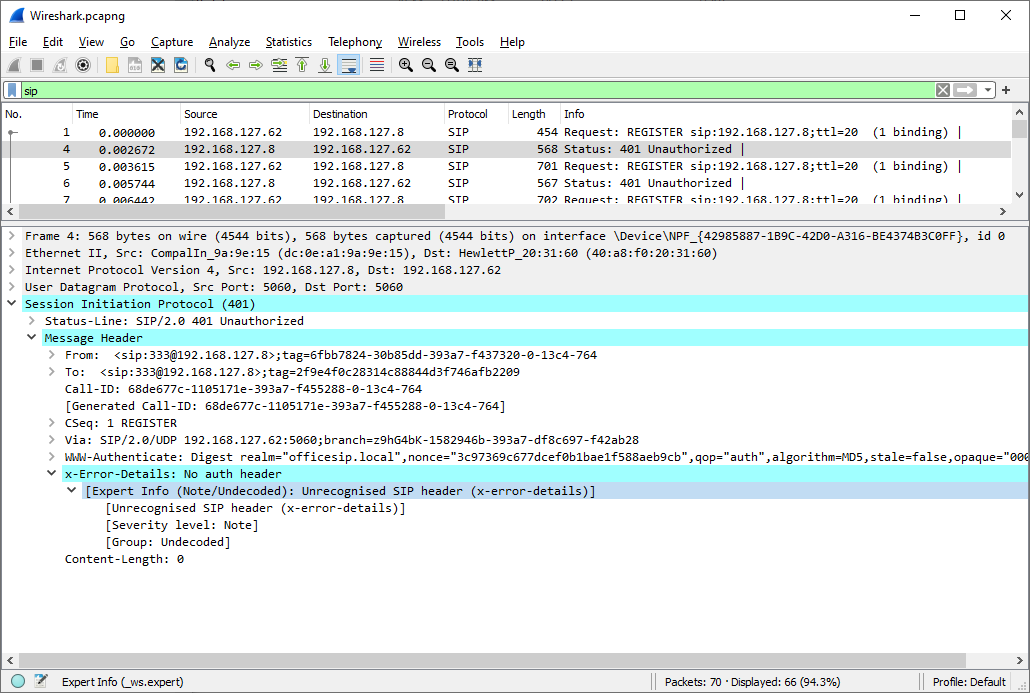

but register is failed , attached file contain all logs VG, Dialogic ,wireshark and office SIP logs
Please support us
Trace1.rar
Regarding the Registration attempt with "OfficeSIP": WireShark trace shows HMP/VoiceGuide is sending a standard REGISTER message to 192.168.127.8, but OfficeSIP keeps replying to that message with a "401 - Unauthorized" along with some "Unrecognised SIP header" error.
 OfficeSIP software's website seems to no longer be up, so it may be difficult to establish what the issue could be. What version of OfficeSIP  is being used here?

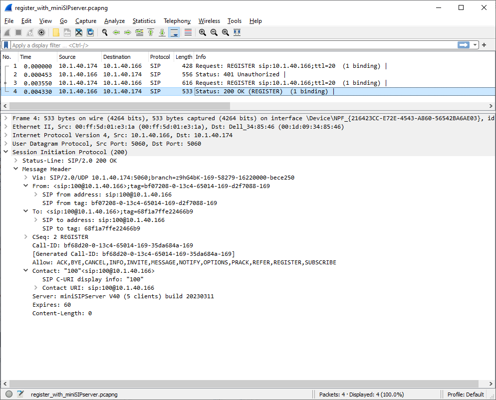

To test SIP registration on a simple local setup one option is to use MiniSipServer from https://www.myvoipapp.com/
You can install it on another machine on same network segment. MiniSipServer comes pre-configured with a few extensions. (eg: user/pass: 100/100).
This VoiceGuide configuration in the <VoIP_Lines> section of the Config.xml is all that's required to register with it:

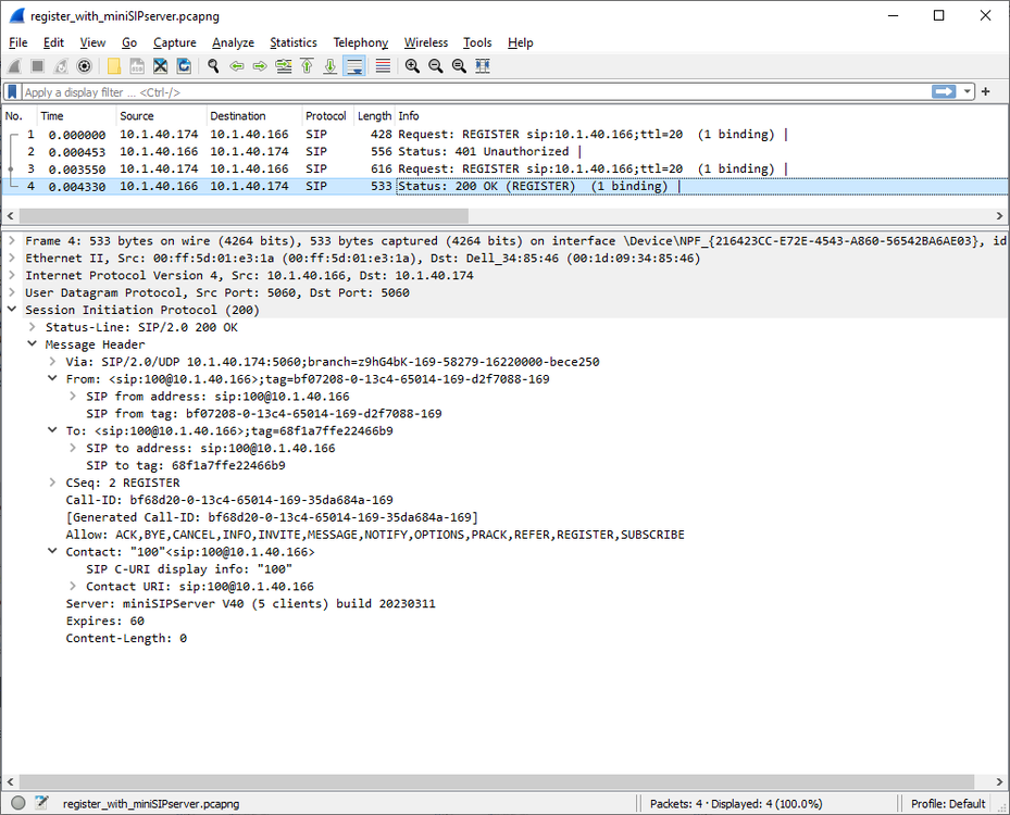

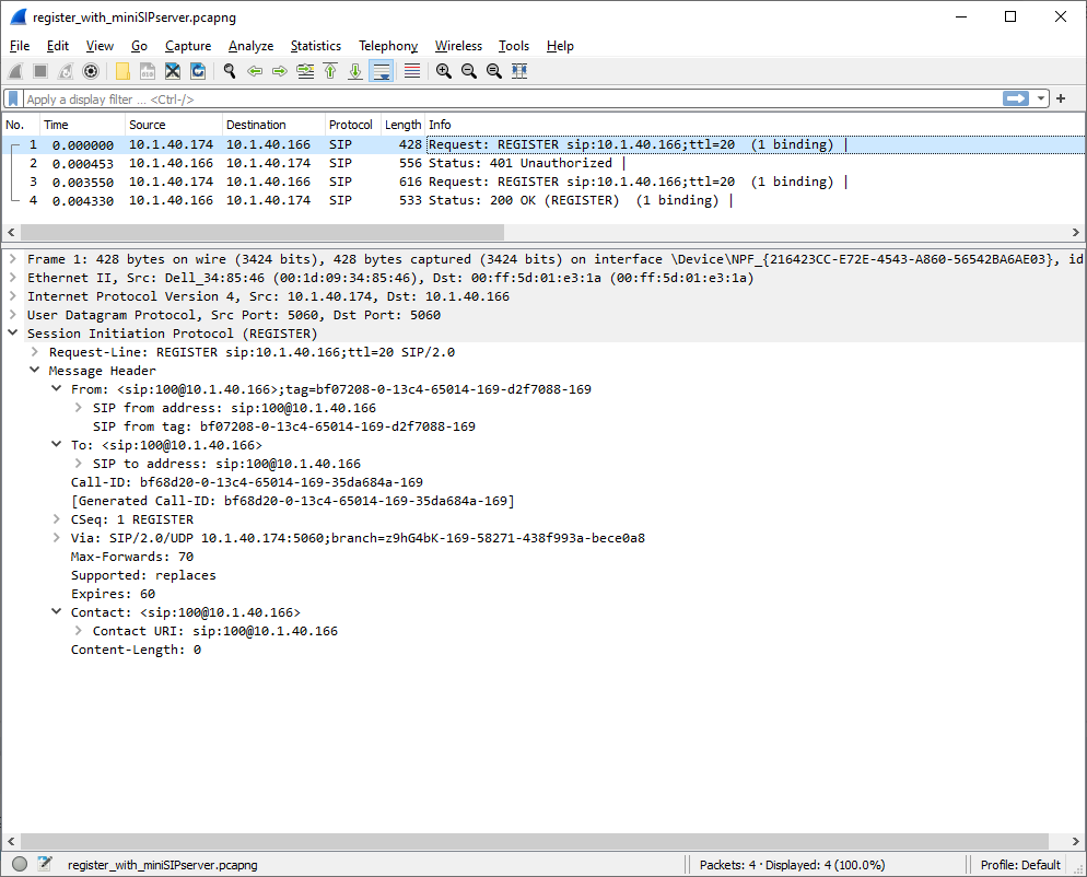

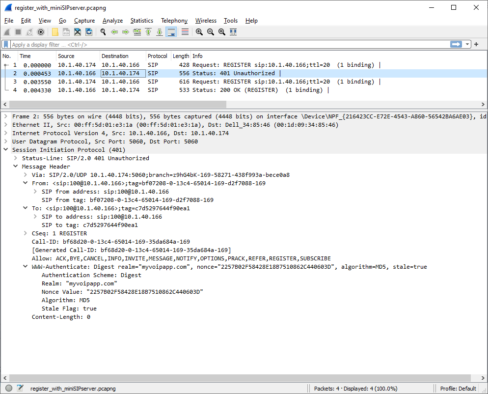

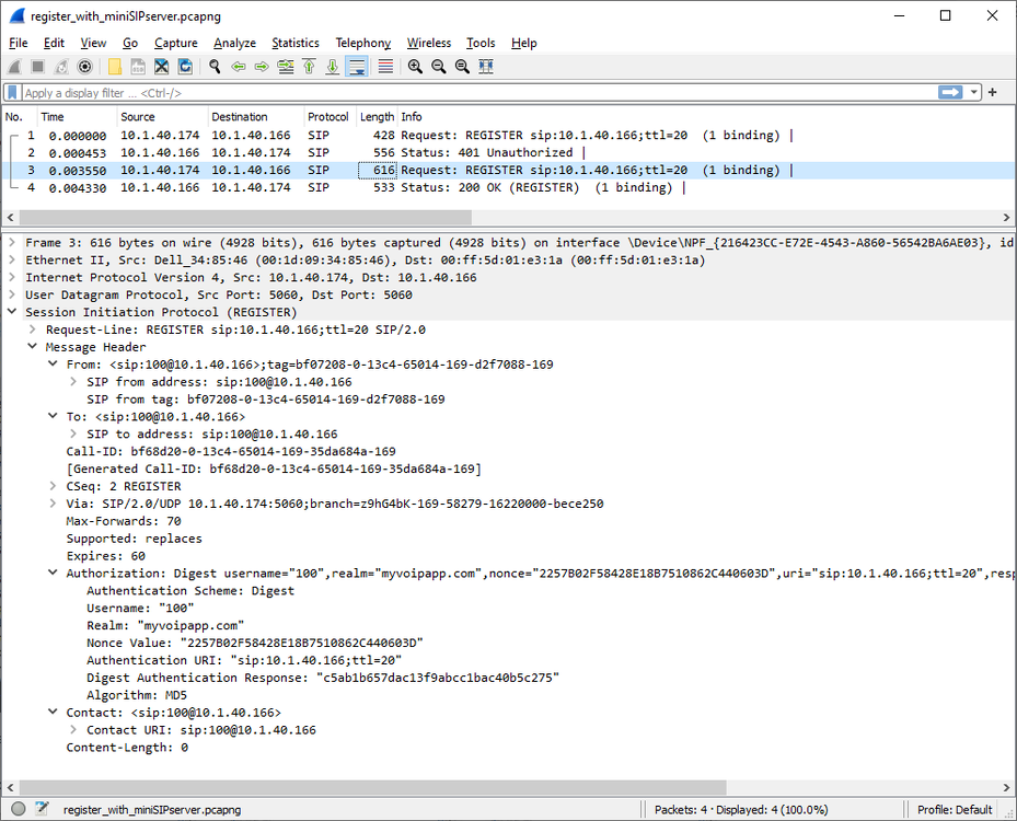

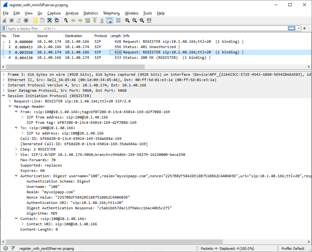

WireShark capture of the registration:
WireShark Trace file:
register_with_miniSIPserver.pcapng
