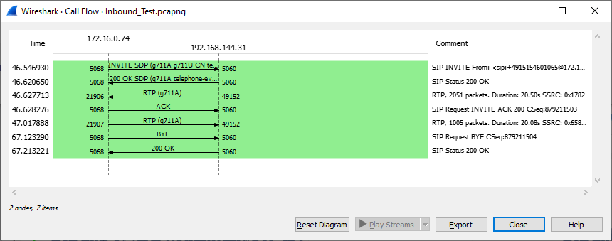

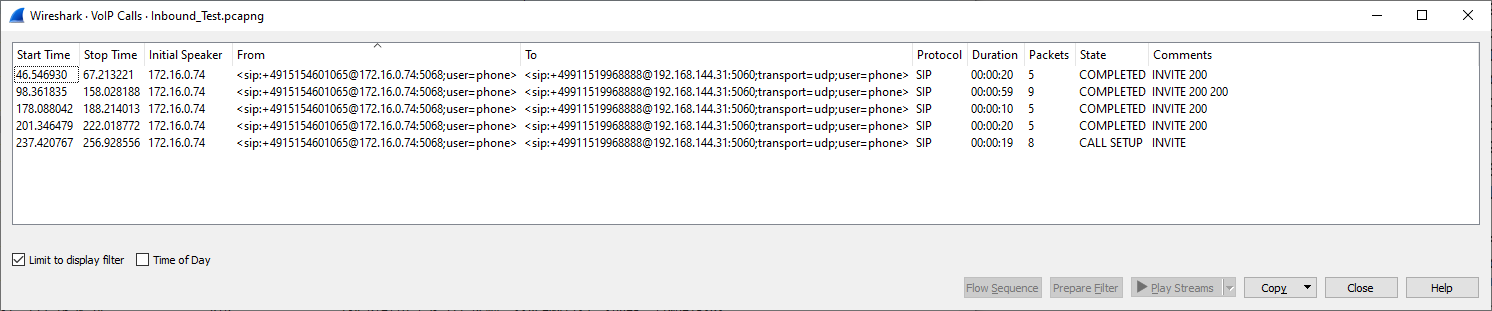

Looking at inbound calls:
5 calls captured by WireShark:
with 1st call at WireShark's 46.547 second timestamp.
call comes form IP 172.16.0.74 and is answered by Dialogic HMP / VoiceGuide system at IP 192.168.144.31.

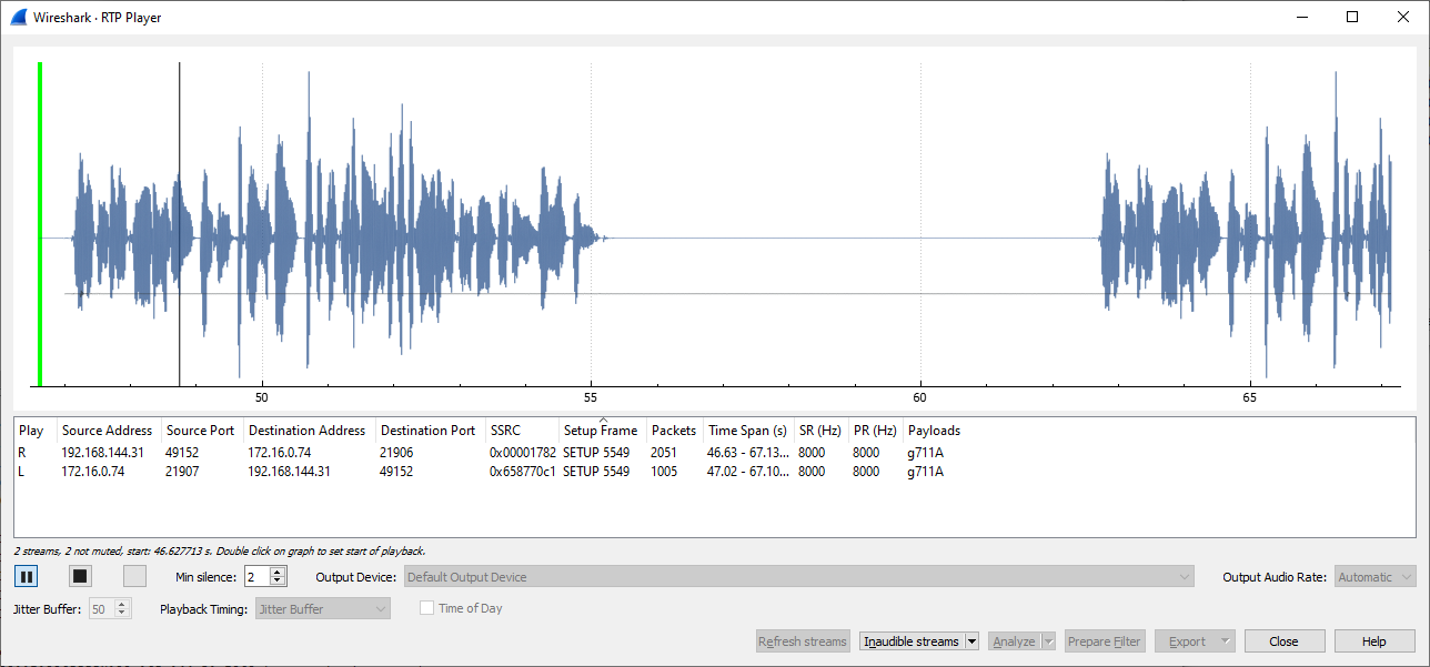

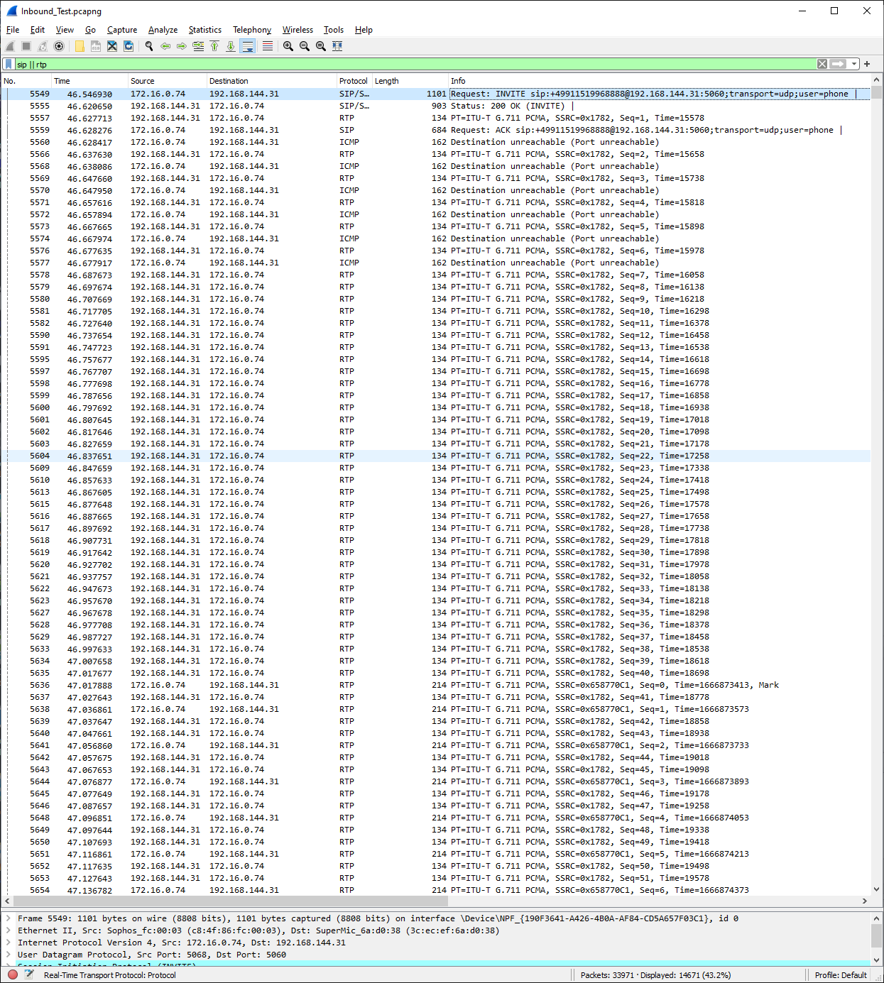

We can see that RTP packets are sent from 192.168.144.31 to 172.16.0.74 immediately after answer:
and when playing the RTP data in WireShark we can see that Dialogic HMP/VoiceGuide played out the credit card payment demo starting message:
so the voice data was sent out on first call.
VoiceGuide completed playing the sound file, then waited about 7 seconds and started transmitting the sound file again - and call was ended when calling party hung up halfway through that second sound file play, almost 21 seconds after starting the call:

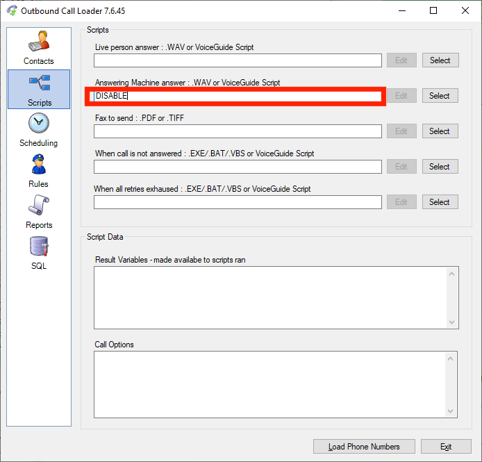

I already read about this Option but i can´t find them. Where can i disable the Detection?
Are you loading outgoing calls using the Outbound Call loader app ?
In the Outbound Call loader app the Answering Machine script/sound/action is set on the "Scripts" page. Please see below:

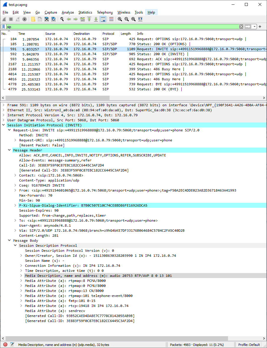

1.: Voiceguide sends "Busy here" to an Option Packet after INVITE. I think this is because we use the Evaluation Version? This is maybe a Problem for the SBC.                                                              There is also no trying and ringing Packet. But this is apperently no Problem for the SBC.
 2.: Our Session Border Controller asks for Payload on Port 20753. But Voiceguide sends to Port 20752. Is there a negotiation Problem?
3.: The Frame Rate should be 20 ms. Voiceguide sends with 10 ms.

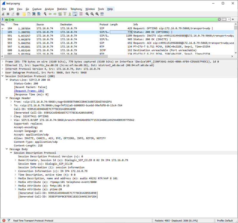

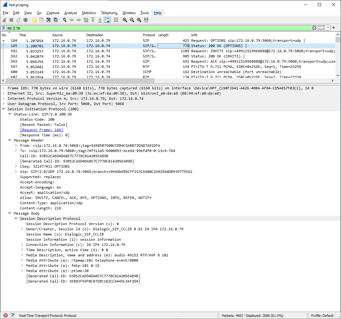

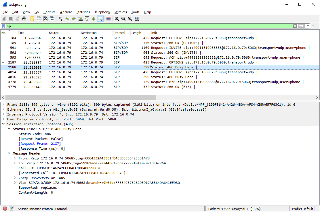

This is most likely because you are running a 1 line evaluation license from Dialogic HMP.
Note that the OPTIONS message sent before the INVITE is being responded to:
and it's only the OPTIONS messages sent 6 seconds after call answer that are being replied to with a "486 Busy Here" - while that one evaluation channel is busy on an active call, and the system is not able to accept any new calls:
The "100 Trying" and "180 Ringing" are optional messages. And in cases where system answers call immediately they are unnecessary - so the Dialogic HMP just immediately sends the "200 OK" to indicate call is answered.

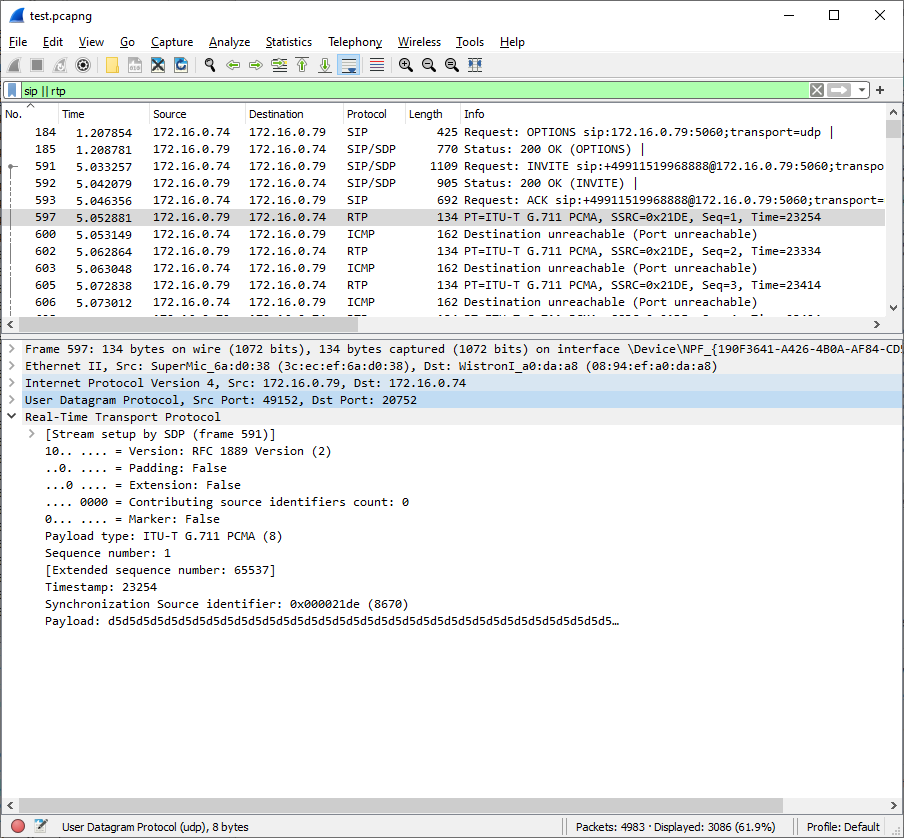

Traditionally RTP was sent on even numbered ports only.
original RFC2327 https://www.ietf.org/rfc/rfc2327.txt : at bottom of page 18: "For RTP compliance it should be an even number."
RFC4566 https://www.ietf.org/rfc/rfc4566.txt  and RFC8866 https://www.ietf.org/rfc/rfc8866.txt don't have that recommendation anymore, but for backward compatibility many SIP devices stick to using even ports for RTP and next-up odd port for RTCP.
Recommend asking whoever is configuring this SBC to get it configured so that it uses even numbered ports when specifying it's RTP ports...
This could be as simple as setting the start of the allowed RTP port range to be an even number, and then setting a "RTP UDP Port Spacing” type setting to be an even number as well, but it depends on device.
Looks like the Dialogic HMP is set to adhere to follow the old RFC recommendations of using the even RTP port numbers only, and just ignores the lats bit in the port number - dropping back to an even number in cases where odd number is specified...
Looking at the INVITE and OK responses it does not look like any particular packet size was requested by either side. VoiceGuide / Dialogic HMP defaults to 10ms as this setting minimizes time delays between the two parties.
