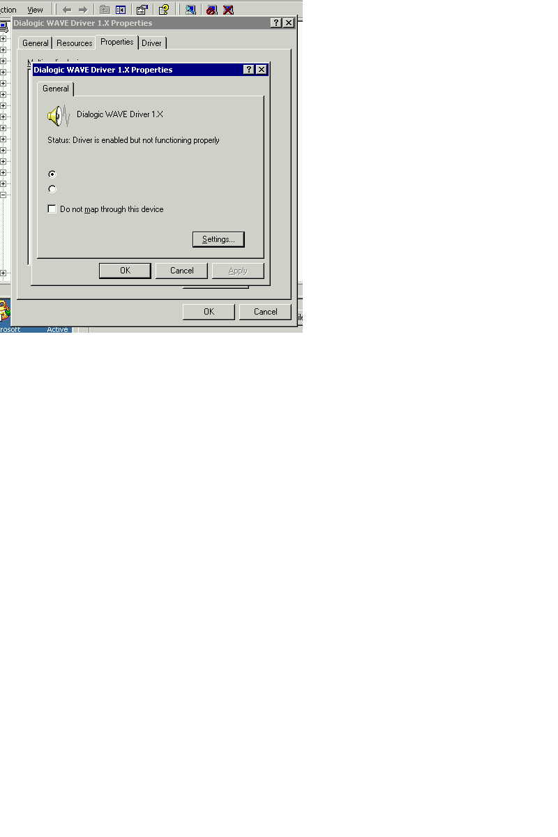

Have you installed the Wave drivers for the card as per instructions in:
http://www.voiceguide.com/vghelp/html/Inst...allDialogic.htm ?
Which version of VoiceGuide are you using?
If you are still having problems after double checking the wave drivers please install v5.2.1. Then start VG and open the "Trace Log" window and check the "Save to log file" box. Then after making a test call please .ZIP and post both the MMDDvgm.txt and MMDDtw.txt log files files from VG's \log\ subdirectory.
Have you looked through the other screenshots of Wave driver's configuration which are available on http://www.voiceguide.com/vghelp/html/Inst...allDialogic.htm ?
Do they all look the same?

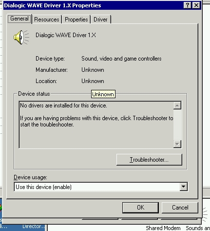

From the traces it looks like the cards Wave drivers were not correctly installed - can you try removing all the wave drives on your system (including any sound card drivers) and then re-installing the wave drivers for your telephony device first. Try calling in after doing this, and if the sound can be heard over the phone you can then try to re-install your sound card drivers.
To remove other wave drivers got to Control Panel, double clock on System, select the Device Manager tab and go to Sound/Video/Game Controllers entry - then delete all other wave drivers.
You may have to disable the sound card altogether as well to stop Windows from automatically loading it's drivers - to do this just select "Disable" and then select "Uninstall" from the Device Manager.

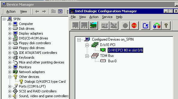

ok. I think I can see the problem, but not sure about how to resolve it. when I go into the config after reinstalling the driver it tells me in the dialogic WAVE Driver configuratio window that the number of Channels is 0. why would this be ?
thanks for all your help
Jeremy
Was the Dialogic card started at the time when you were looking at the Dialogic Wave driver configuration?
Usually when the value of 0 is presented then it's because Dialogic cards are not started.
The best way I think would be too uninstall everything, including any other wave drivers and start installation again - following exactly the steps outlined in: http://www.voiceguide.com/vghelp/html/Inst...allDialogic.htm
Did you do the other things suggested in the "Also:'" points of our previous post?

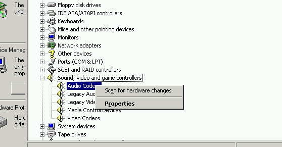

I have tried removing all the drivers and reinstalling the wav drivers, but it is still not working
I do see a few drivers that I can not uninstall as I have no option to . these are
one called audio codec
Legacy audio drivers and media control devices.
any suggestions ?
We can see from the screenshots that something is badly wrong with the wave drivers on this system. You could be going in circles forever trying to figure out exactly what is causing this, but I'd just recommend:
1. reformat HD
2. install Win2000 + SP2 (or SP4)
3. install Dialogic SR5.1.1
4. go through the steps in http://voiceguide.com/vghelp/html/InstallDialogic.htm
No. If you cannot figure out what is wrong with the drivers or the Windows' sound sub-system then the quickest way is to just reformat and start from scratch. That will take you 1-2 hours and it looks like you've spent 3+ days on this problem already...
