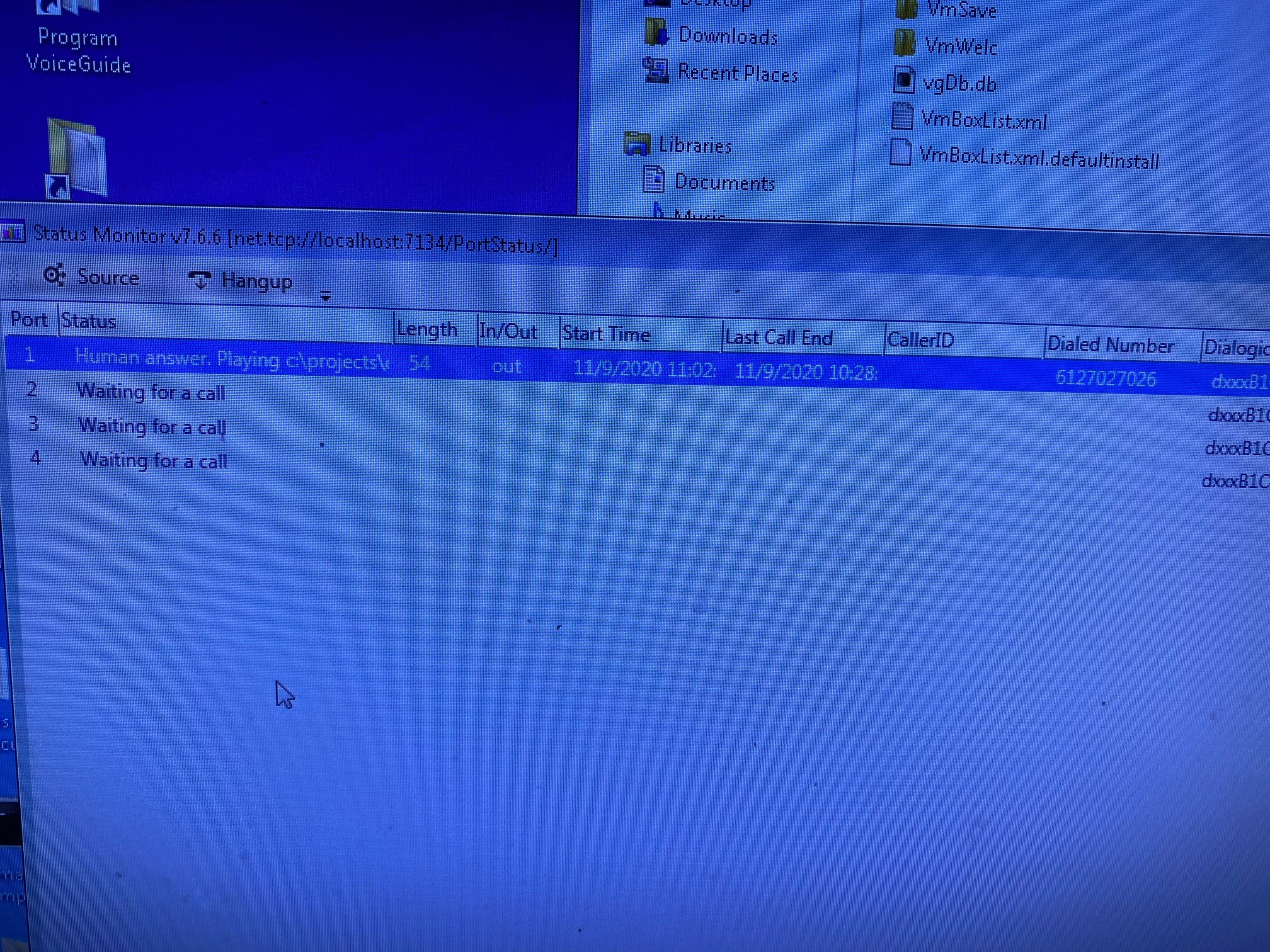

Hi i use very simple outdial script
it reports that it calls out and shows even "human answer"
what happens? Number shown is mine! No missed calls I can call carrier but I am curios where it called?
and where it calls?
11.thumb.jpg.ec11209d6942289195fb70e7853aadc7.jpg Number shown

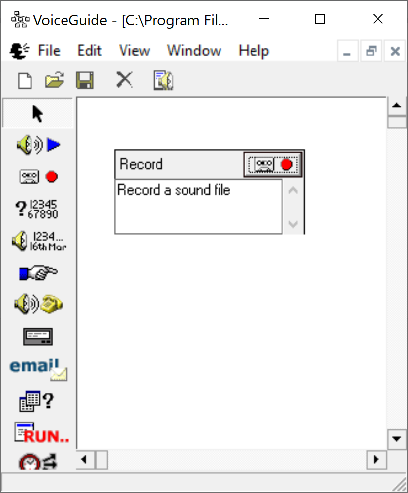

Can you please do this call again, but for the script that is ran when the call is answered specify a script that just has a single record module in it. This way you will get  a recording of what is heard by the system after the call is detected as answered - and that recording may be useful in determining  what happened to that outgoing call.

It says it calls and shows "human answer"
Nothing comes my phone
where I can see in log what number really was dial;ed?
Create a VoiceGuide script that consists of just a single Record module. See screenshot below, and the attached script below.
JustRecord.vgs
Then instead of "c:\projects\outdial\wav\wav6912875.wav" specify that script in the loaded outbound call.
When call is detected as answered that script will record a sound file of what the system hears on the line.
That recording may be useful in determining  what happened to that outgoing call.
Also: is this an analog system? If yes then what do you hear when you attach a telephone to the line that VoiceGuide is using to make the outgoing call and dial that same number?
