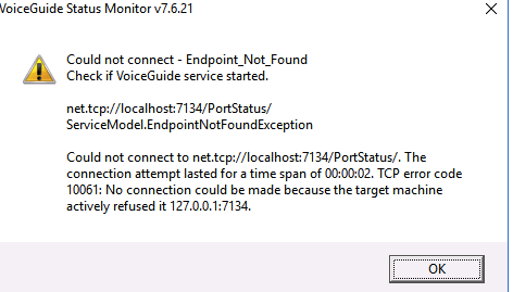

D.H. Report post Posted 07/10/2020 03:02 PM Hi support, Our system always popup this status monitor end point not found error, and then the line status stop working. Please check and advise how to solve. Share this post Link to post

SupportTeam Report post Posted 07/11/2020 07:25 PM This looks like either some anti-virus type software is blocking the ports from being opened, or you have another copy of status monitor running in the background. Can you try disabling any anti-virus type software on your machine and then restart Windows. After Windows restart conform that the Anti-virus did stay turned off, confirm the VoiceGuide service has started, and then start the Line Status Monitor. If you then still experience problems then please contact support@voiceguide.com directly an quote this support forum thread. If we can have a quick look at this machine the we can probably establish what the issue is here. eg: maybe some other software is using the tcp port 7134 on this system? I which case you can set the Line Status Monitor to use named pipes (net.pipe) or http method to connect instead. Share this post Link to post

SupportTeam Report post Posted 07/13/2020 05:52 PM Is this installation running in Evaluation mode? Traces from your post from 2 weeks ago show that this installation is running in evaluation mode: Quote 213255.946 20 reg UNREGISTERED EVALUATION VERSION, lines: 30 id: CARD[GM018051] In evaluation mode the software will only work for around 1 hour at a time, with full restart of all VoiceGuide programs/services required after 1 hour (mostly 1 hour, sometimes less) Share this post Link to post
D.H. Report post Posted 07/14/2020 04:22 PM Hi Support, yes, this is evaluation mode. So the problem should be solved with a valid license, right? Share this post Link to post
SupportTeam Report post Posted 07/14/2020 07:17 PM Yes. Once licensed the software will work continuously without requiring periodic restarts. Share this post Link to post
