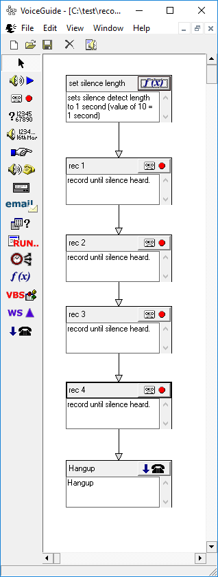

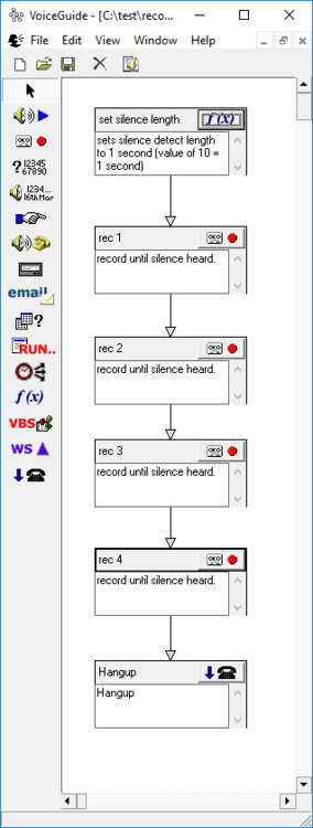

Here is a sample script created to demonstrate how this is done:
Here is the .VGS file itself (open .VGS in VoiceGuide Script Editor):
test1.vgs
The above demo script sets the silence length to be 1 second, and then records up to 4 sound files with script moving to next record module whenever a 1 second silence is heard.

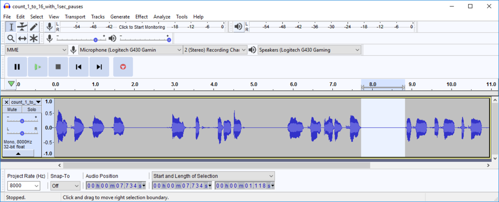

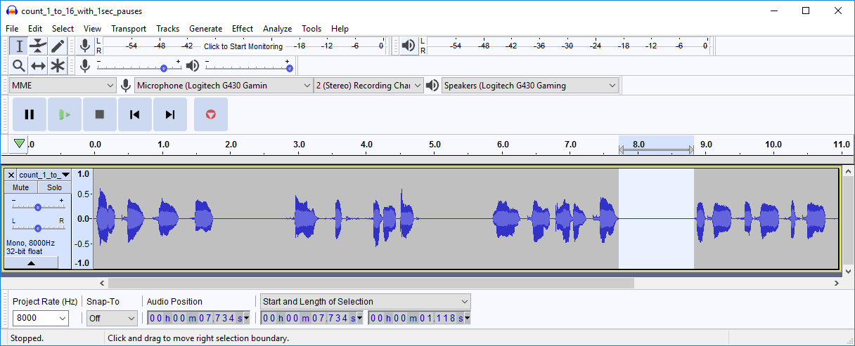

To test this a call was placed into the system and this sound file was played when the "test1.vgs" script answered:
count_1_to_16_with_1sec_pauses.wav
The sound file is a recording of a person saying 1 to 16, with 1.1 second silence gap after each 4th number spoken.
When tested, the system detected the 1 second silence gaps and as expected recorded this into 4 separate sound files.

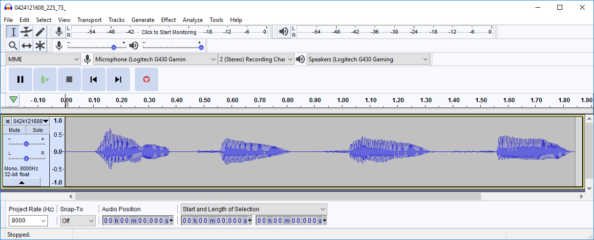

and here are the 4 sound files recorded:
0424121608_225_73_.wav
0424121611_225_73_.wav
0424121614_225_73_.wav
0424121617_225_73_.wav

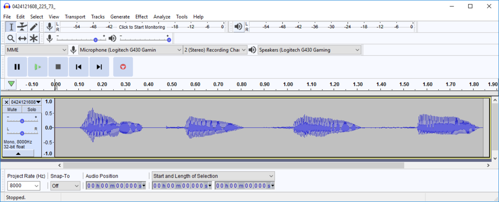

Here is one of the files opened in Audacity:
