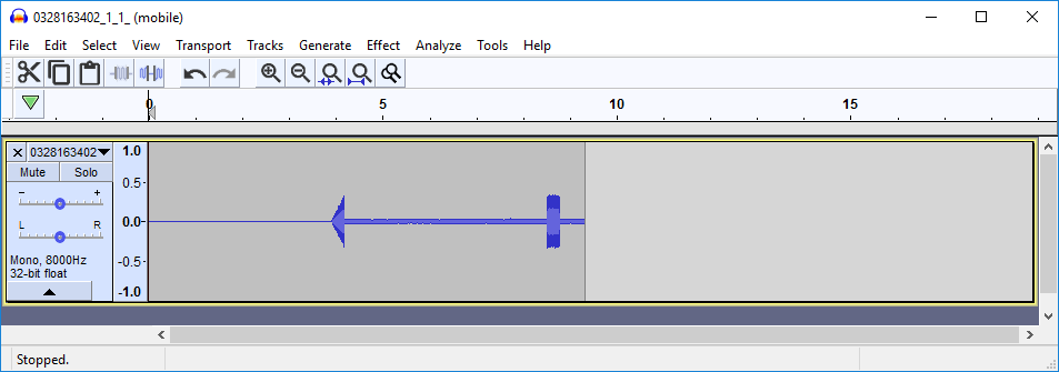

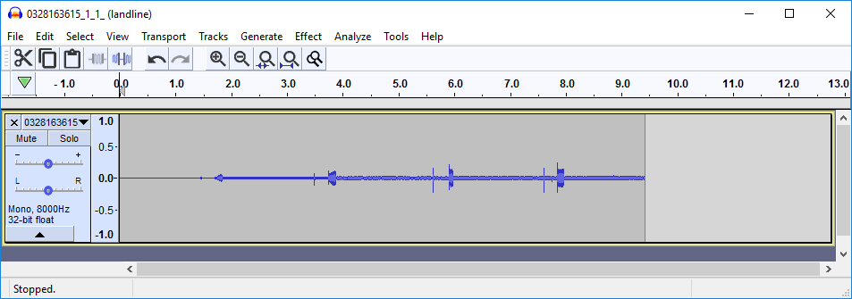

We have performed the recommended testing.  Attached files (including the wav files produced by Record module) here.  Kindly refer to the last 2 sets of testing, one is using mobile phone and another using landline.  For both tests, I entered 8 several times once the call is picked up by the system.

VGTest.zip
The vgEngine trace was not included in the posted .ZIP. Please post the vgEngine trace(s) for the day the tests were carried out.
