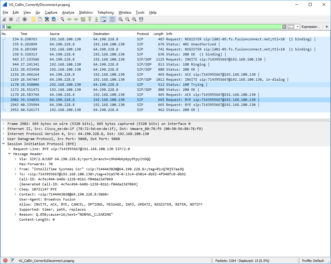

On the incoming call, the device at 64.190.228.8 sends a BYE message to VoiceGuide (192.168.100.130). 'BYE' is the 'End of Call' message.
VoiceGuide/HMP is not detecting any disconnect tones etc. It is told by 64.190.228.8 that 64.190.228.8 is ending the call, and hangups up the channel (returning OK to 64.190.228.8).
See trace below of the incoming call:

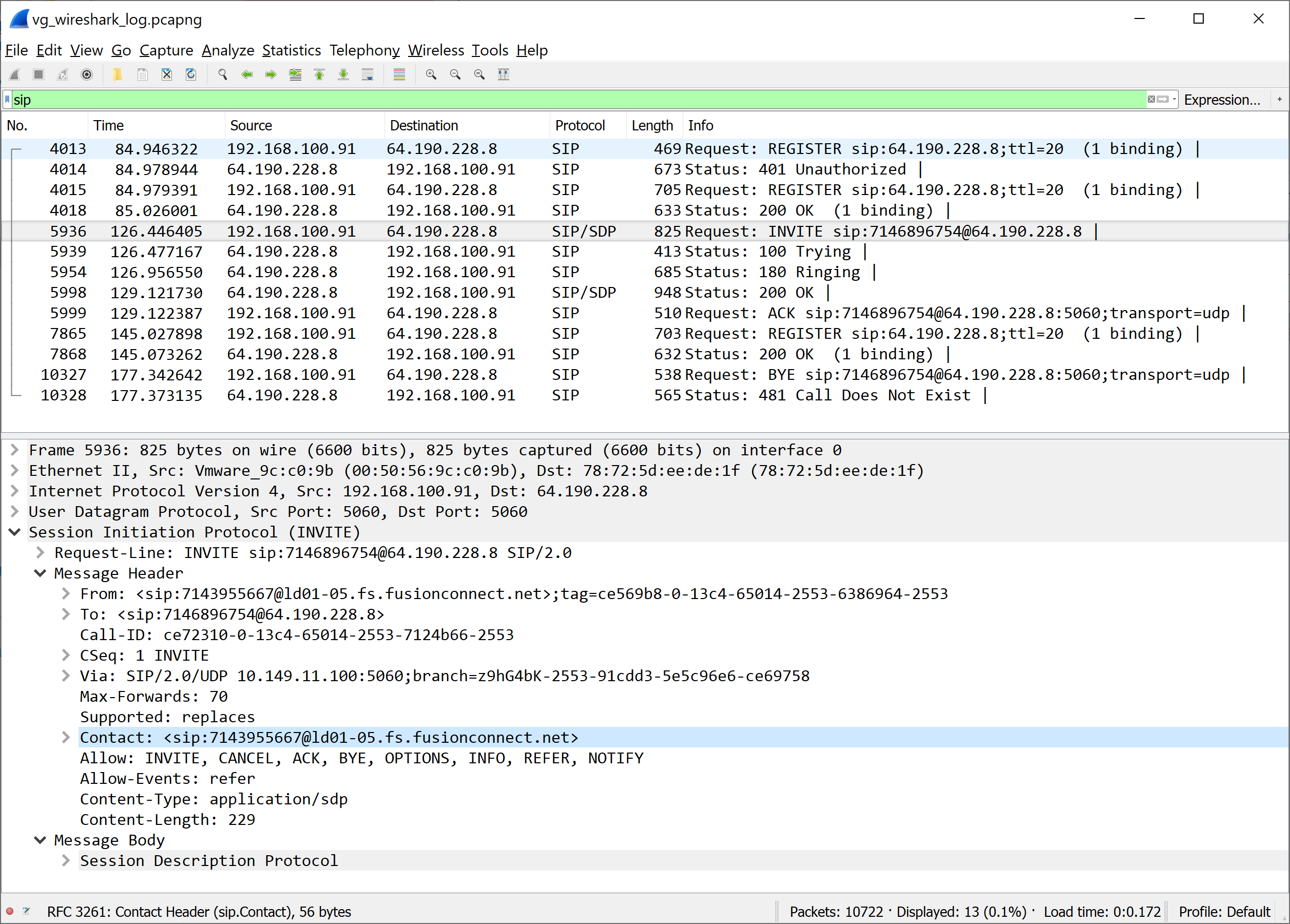

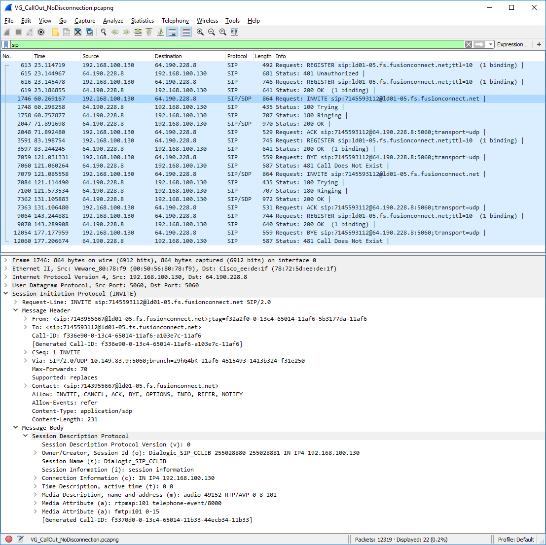

On the outgoing call the 64.190.228.8 did not send any 'BYE' to 192.168.100.130 when recipient of call hung up. You should ask the administrator of device at 64.190.228.8 why that device did not send any 'BYE' when recipient of call hung up.
vgEngine trace shows VoiceGuide timing out awaiting input in module [GetPasswordForDialOut], and VoiceGuide the progressing onto modules [AssignPassword] and [PlayLoginFailed] and the starting the "After Hangup" script PostHangUp_Hiring.vgs and hanging up the call when that script completes.
When VoiceGuide/HMP hangs up the call it sends a 'BYE' to 64.190.228.8. 64.190.228.8 responds to the 'BYE' with a "481". vgEngine trace shows however that VoiceGuide is ready to make new calls (or accept incoming calls) on those channels despite the 481:

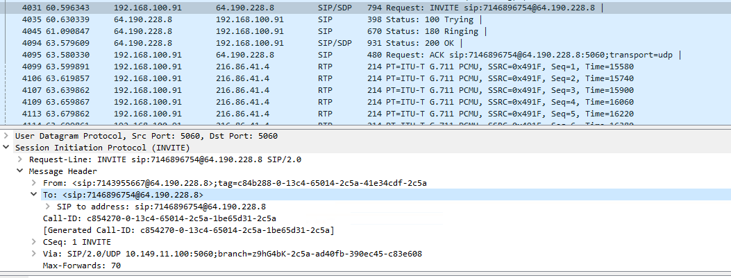

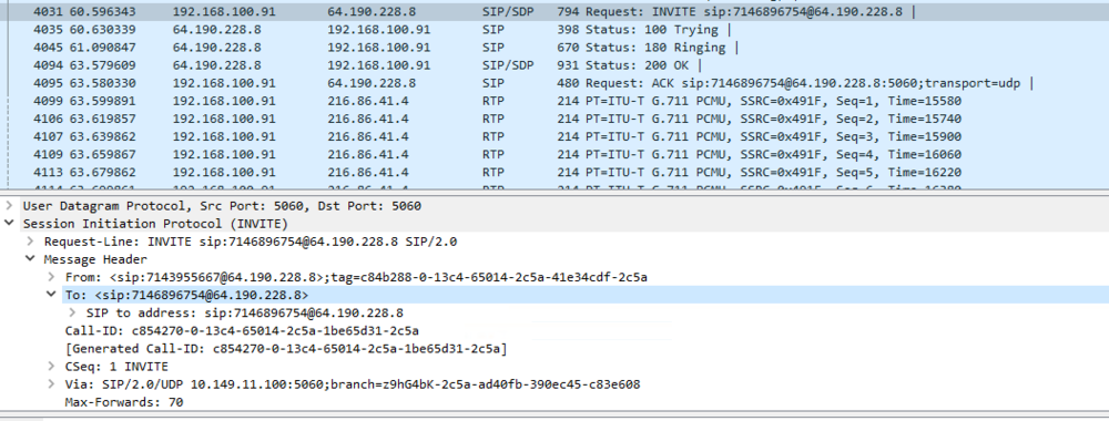

Is is possible to post the WireShark trace of the outgoing calls that were made with IP addresses instead of "ld01-05.fs.fusionconnect.net" ?
We can then have a quick look to see if there is anyhting else there that could be the issue.
Thanks for coming back to us for this issue.

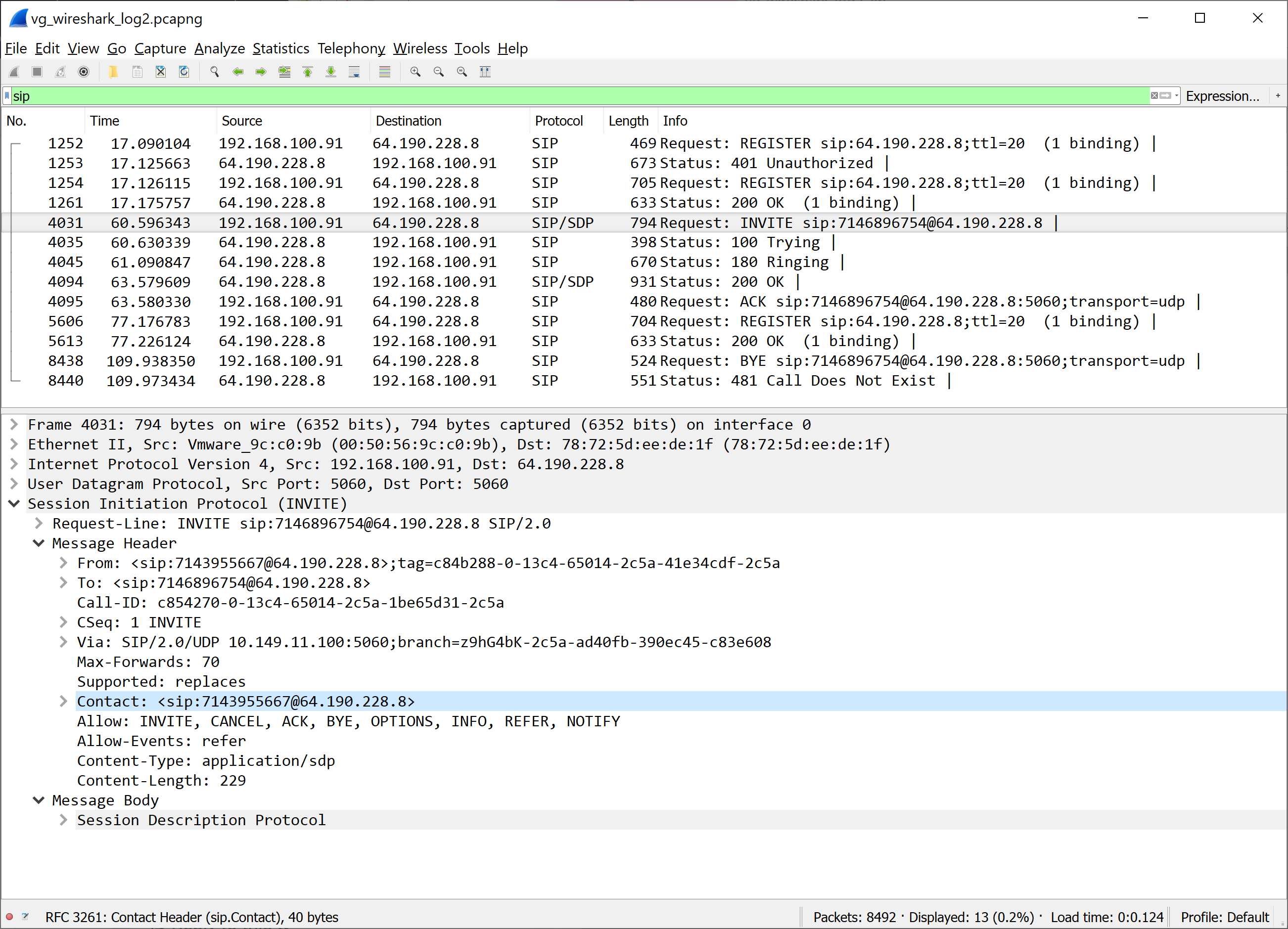

Please find the attached; it has one call out where the user hung up while voice prompt was playing on [GetPasswordForCallOut].
Later, the "BYE" signal was sent by VG Script where we set "TimeOut" that forced workflow to [LoginFailed] module to be disconnected, not by the SIP trunk.
We used the IP address in "RegServer" instead of the DNS name.
Thank you.

When placing the outgoing call please use the IP address in the <CallerId> setting used on the outgoing call.
The <CallerId> option that is currently being used on these outgoing calls is still using "ld01-05.fs.fusionconnect.net"
Please change the <CallerId> setting to use 64.190.228.8 instead.
The <CallerId> setting is used inside the call's 'Options'.
More information on the <CallerId> setting can be found here: https://www.voiceguide.com/vghelp/source/html/dial_voip.htm
It's possible the SIP Switch is expecting that VoiceGuide/HMP's IP is used in the "Contact:" (and From:) fields.
Suggest trying using the IP address of VoiceGuide/HMP system (which is now: 192.168.100.91) in the <CallerId>
If you still get same outcome then suggest contacting SIP service provider, and provide both traces, the one with 64.190.228.8 being used in the <CallerId> and one where 192.168.100.91 is used.

We have just tested your suggested solution.
You were right; the service provider's SIP trunk has sent "BYE" signal correctly once we sent our "<callerid>" with VG's IP address.
The callerID with the SIP trunk IP address used to work fine until recently so I guess they may have changed something on their end.
