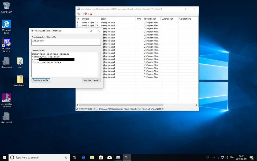

Jean-Francois Report post Posted 08/09/2019 02:38 PM Bonjour. J'ai updater mon système a Win10. J'obtiens ce message, voir image jointe. Le seul changement fait au système est un nouveau disque dur. Pouvez-vous m'aider? Share this post Link to post

SupportTeam Report post Posted 08/12/2019 11:51 AM Forwarded traces showed that a newer version of version of VoiceGuide was installed on the new deployment. The previous deployment used an older version. The previous old license will need to be upgraded to work with newest version of VoiceGuide. Share this post Link to post
