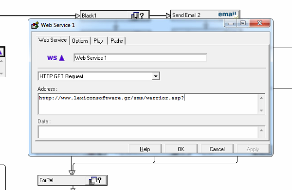

I want to use a web service to send an SMS the caller number
I have filled the web service address and the parameters but i het the error "not supported"
I am sending you the logs
The service address isĀ
0112_1259_vgEngine.zip
This system is currently running v7.3 of VoiceGuide, and has a "Professional" class license.
In v7.3 the Call Web Service module was only supported under the "Enterprise" version.
v7.3 was released over 6 years ago. You will need to upgrade your license to current version of VoiceGuide to use the Call Web Service module.
