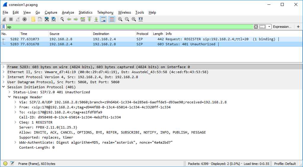

por favor necesito ayuda, por varios días intentado configurar la conexión de la guía de voz con Aterisk -Issabel, pero no por lo que logró que me indica que no está autorizado, que realizó la guía de voz, adjundo documento guardado con wireshark .

The "Realm" entry must match what is returned from PBX/Switch, or should be left blank if any Realms are to be matched.
ie: change:
<Realm>192.168.2.4</Realm>
to either:
<Realm>asterisk</Realm>
or to:
<Realm></Realm>
The "Identity" entry must be left blank. The "Identity" is only used in rare configurations.
so also change:
<Identity>IVR1</Identity>
to:
<Identity></Identity>
For more information please see: https://www.voiceguide.com/vghelp/source/html/config_voip_register.htm
The registration will need to be successful before any calls are attempted. WireShark will show whether the Registration was successful or not.
The previously posted traces shows the registration was not successful:
If after clearing the <Realm> and <Identity> entries you are still encountering problems registering you can try changing:
<AuthUsername>170</AuthUsername>
to:
<AuthUsername>170@ 192.168.2.4</AuthUsername>
