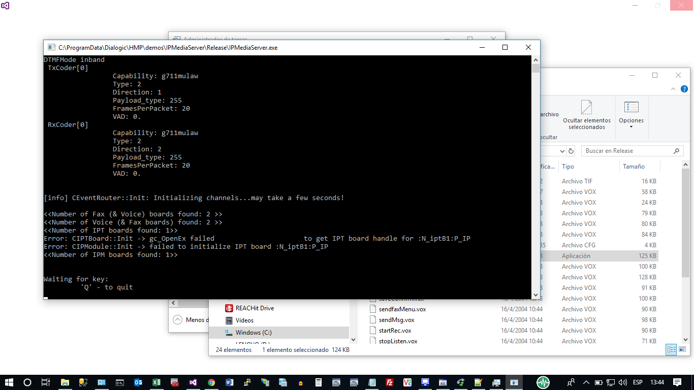

Estimados,
por favor su ayuda.. al realizar las pruebas me aparece el siguiente error. que puedo hacer ..??
Google Translate:
please your help .. when performing the tests I get the following error. What I can do ..??
Is the Dialogic service started?
What happens when you try to start the VoiceGuide service?
Can you please .ZIP up and post all of the files in VoiceGuide's \log\ subdirectory. We can then see what is happening on the system.
