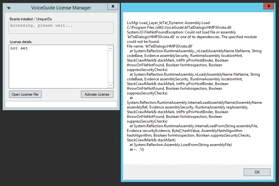

I'm experiencing problems with the installation of VoiceGuide onto a new Windows 2012R2 server. The installation appears to complete successfully and the installLog.txt file shows no errors.
However, the VoiceGuide Service is missing from Windows Services, and when I start the VoiceGuide License Manager I get an error (refer to attached screenshot).
The Dialogic HMP drivers have been installed successfully and the Dialogic service is running.
It would appear that something has prevented the installation from completing properly, but I'm unable to see the cause.

Thanks. I've installed the current version of Dialogic HMP and VoiceGuide. The problem has now been resolved.
Looks like there was a problem with the specific VoiceGuide install build that I was trying to use.
