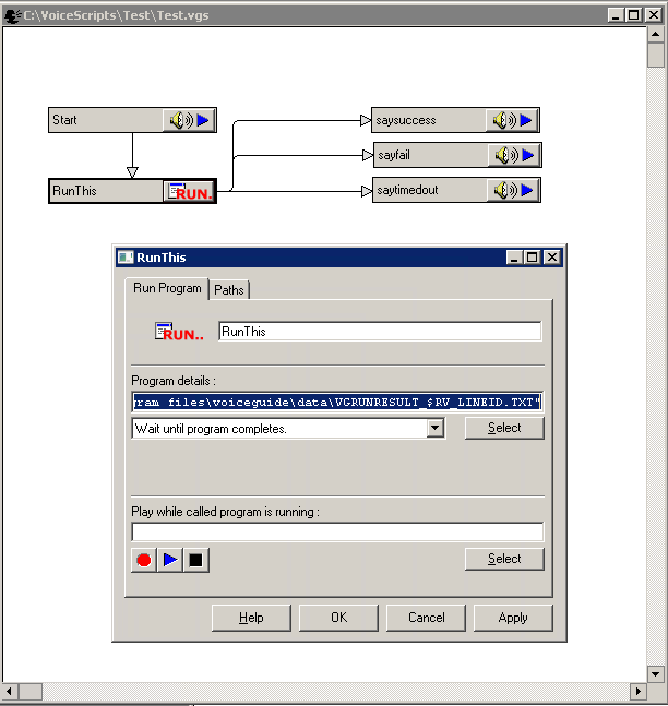

We have run into an issue where the run module returns a fail when it should return a success. The run module is set to wait for program to finish. The program details are as follows:
c:\sox-14-3-2\sox.exe c:\vgtemp\it_msg\1.wav c:\vgtemp\it_msg\1.mp3
The program simply takes a wav file and converts it to mp3. The sox program being called executes successfully and creates the mp3 file. So we added the result file at the end of the command giving us this:
c:\sox-14-3-2\sox.exe c:\vgtemp\it_msg\1.wav c:\vgtemp\it_msg\1.mp3 > "c:\program files\voiceguide\data\VGRUNRESULT_$RV_LINEID.TXT"
this results in a timeout. With no VGRUNRESULT being created.

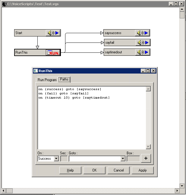

this php creates a file named VGRUNRESULT_$RV_LINEID.TXT in voiceguide\data that contains [variable]{12345}. This still results in the timeout path being taken. Why is the run module not returning success?
VGRUNRESULT file is something that can optionally be created by the ran program to return information/results back to VoiceGuide afterwards.
It is not however necessary that any information/results be returned to VoiceGuide from a ran program.
Starting the program and then letting the module take the 'fail' path afterwards is fine. The 'fail' path does not necessarily mean that something went wrong with the running of the program, just that no 'results' were returned.
Trace shows that when sox.exe is called the system is not able to detect that program stopped running, and eventually a timeout path is taken. Not sure why the system would not detect the end of process running.
Can you try to run the sox.exe without the redirect ( the '>' ) at the end?
ie. make the command line just:
command.com /c c:\sox-14-3-2\sox.exe c:\vgtemp\it_msg\1.wav c:\vgtemp\it_msg\1.mp3
sox.exe output would not be in format expected by VoiceGuide anyway.
(What is the output of c:\sox-14-3-2\sox.exe c:\vgtemp\it_msg\1.wav c:\vgtemp\it_msg\1.mp3
when it is ran from a normal Windows cmd.exe window?)
The Run Program module does not have to take a 'Success' path afterwards. The Run Program module starts the command line and taking a 'Fail' path afterwards does not mean that the ran program did not function, it just means that the ran program did not return explicit results using either the COM/WCF interfaces or the result file. Also if the outcome of the ran program is not needed immediately by the VoiceGuide script then there is usually not need to make the script wait for that ran program to complete.
