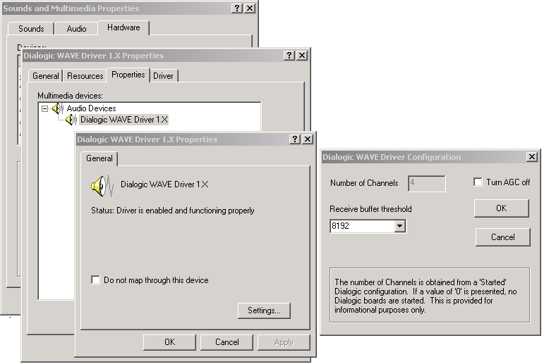

Questions for the Dialogic Voice Driver:
1) Should the "Map through this device" be checked?
2) Should the buffer value be 8196?
3) Should AGC be checked off?

These are the settings for the Dialogic Wave driver which are on our test system (which records OK):
