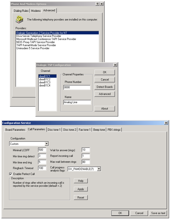

The number of rings after which the incoming call is reported by Dialogic to VoiceGuide can be set in the Dialogic's TSP configuration.
On Win2000:
1. Open "Control Panel -> Phone and Modem Options",
2. Go to "Advanced" Tab
3. Bring up the "Dialogic Service Provider"
4. Click "Advanced"
5. Go to "Call Parameters" tab
6. See the "Report incoming call" setting.
