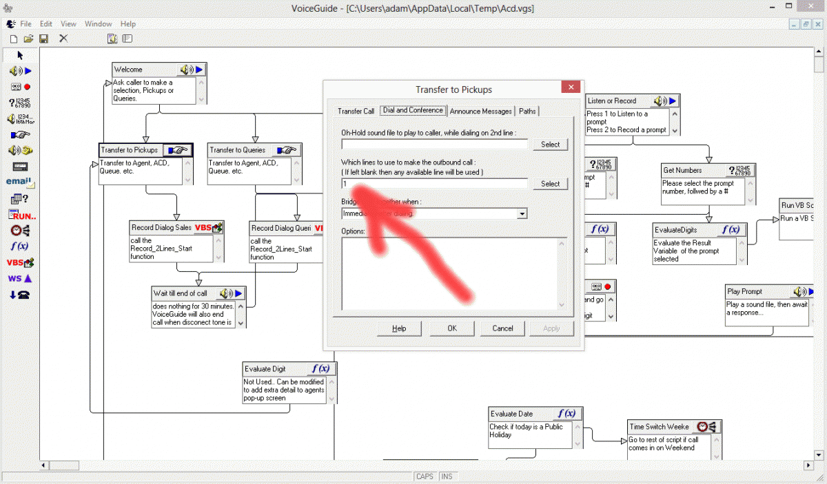

I have not specified the port at all as there is NO place to actually specify the port within vg. I will attach the script
Similar problem existed before and a patch was written...http://voiceguide.com/forums/index.php?showtopic=8794&hl=dialer&do=findComment&comment=35061
Acd.vgs
Please see attached image.
Arrow points to where the port selection list is specified in the "Transfer to Pickups" module.
(the "Transfer to Queries" module has similar setting so you should change that module as well)
