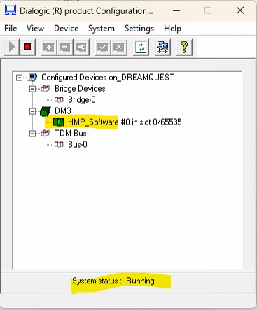

Frank.Schwarz Report post Posted 11/28/2025 10:50 AM Hello VG Team, Thank you, the SIP has now registered in the 3xC system. When I call the number, it is displayed in StatusMonitor, but no connection is established. What else is wrong? Thank you very much in advance!!! Frank 2025-11-28.zip Share this post Link to post
SupportTeam Report post Posted 11/29/2025 12:44 AM Please .ZIP up Dialogic RTF logs in Dialogic's \log\ subdirectory - usually "C:\Program Files (x86)\Dialogic\HMP\log" - and post the .ZIP file here. Share this post Link to post

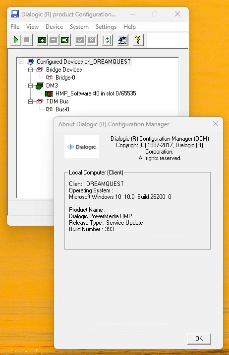

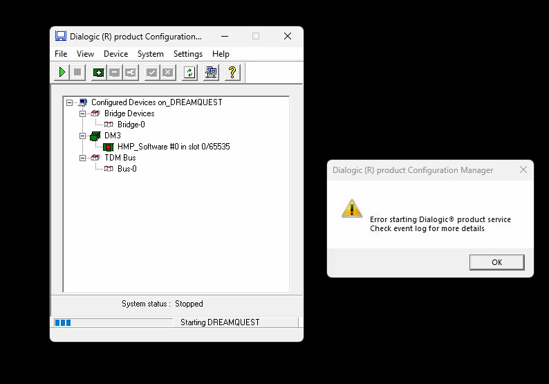

Frank.Schwarz Report post Posted 12/02/2025 11:01 AM Hello VG Team, I uninstalled HMP 540 and VG 7.7.10, then restarted the PC. I then installed HMP 393 and restarted the PC. After that, the error message appeared. No antivirus software is installed on the PC. There are no other SIP installations either. The PC only has WINDOWS installed as its operating system, along with HMP / VG and WireShark. Attached are the logs. Thank you. HMP.zip Share this post Link to post
SupportTeam Report post Posted 12/02/2025 09:29 PM Sounds like HMP SU393 did not work on this "DreamQuest Mini-PC" hardware either. btw: What was the error message? Share this post Link to post
