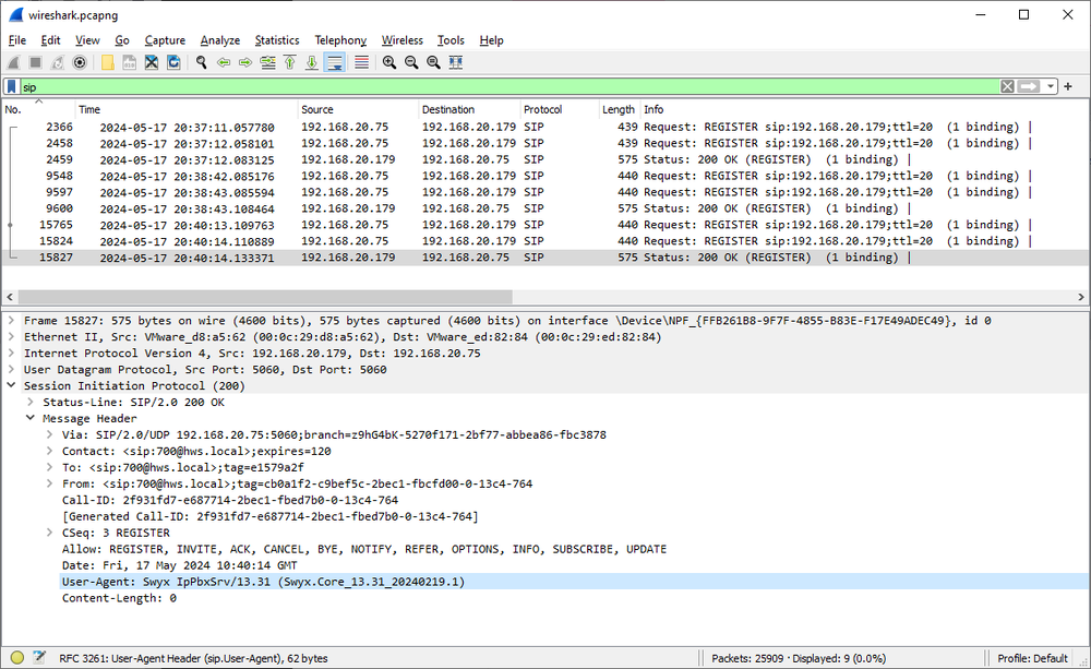

Frank.Schwarz Report post Posted 05/17/2024 10:53 AM Hello Voiceguide Team, It seems that the line is now registered. However, there is no call on the Voiceguide. Please find attached the loggings (Wireshark/SWYX/VoiceGuide). Can you please check this? Thanks a lot Frank 2024-05-17_Logging.zip Share this post Link to post
SupportTeam Report post Posted 05/17/2024 10:06 PM Supplied WireShark trace shows that Swyx PBX is replying with an OK to a SIP REGISTER sent to it from 192.168.20.75 The WireShark trace is not showing any calls (ie. any SIP INVITEs) being sent from Swyx to IP 192.168.20.75 You should contact the Swyx PBX supplier and ask them why that PBX is not sending the calls. Share this post Link to post

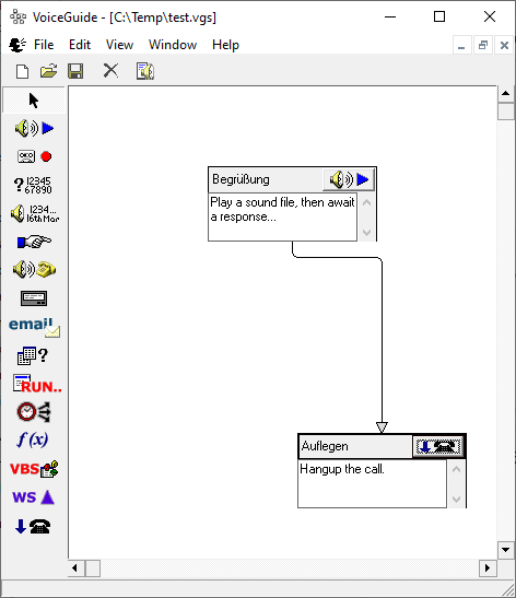

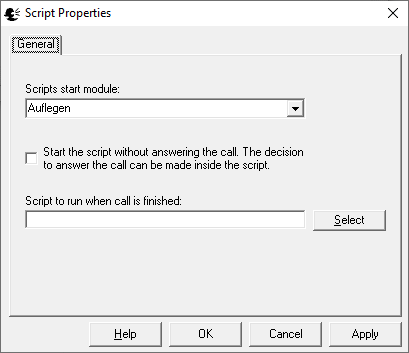

SupportTeam Report post Posted 06/13/2024 11:44 AM The "Start Module" of the script that you are using is set to the module named "Auflegen". The module named "Auflegen" is a 'Hangup' type module... This is why VoiceGuide hangs up the call immediately after answering it... In the Script Deisigner go to "Edit"->"Script Properties" to set the "Start Module" : From looking at the vgEngine trace you can also see that the first module ran after answering the calls is "Auflegen" : 155217.220 24 3 1 2 ev CallState GCEV_ANSWERED, crn=8000001, iEvent=0 ,256,1,4, s1:, s2:, s3:, build_date: 2022-06-18 18:34:35.66 155217.220 24 3 1 2 q_scr + evCallState lcode=0 scode=[GCEV_ANSWERED] 155217.220 19 3 1 2 q_scr run evScriptEvent 2050 GCEV_ANSWERED action_id=0, crn=8000001 [2050|0|0|0|0][|||||] 00:00:00 max:1|0,5079 155217.220 19 3 1 2 evscr GCEV_ANSWERED 2050 2050|0|0 || LineState=LS_OFFERED_ANSWERINGCALL 155217.220 19 3 1 2 q_scr run evCallState 0 GCEV_ANSWERED action_id=0, crn=8000001 [256|1|4|0|0][|||||] 00:00:00 max:1|0,5079 155217.220 19 3 1 2 callstate crn_event=8000001 0|GCEV_ANSWERED state=256|Connected calldirection=1 gcCallState=4 [||], ScriptState=LS_OFFERED_ANSWERINGCALL 155217.220 19 3 1 2 LineEvCallState L1_current=Offered crn_event=8000001,ev=0,GCEV_ANSWERED,1, sParam1= 155217.220 19 3 1 2 LineEvCallState CONNECTED begin 155217.220 19 3 1 2 set crn_connected=8000001 visual_ivr_session_id=842364669 (called from LINECALLSTATE_CONNECTED) 155217.220 19 3 1 2 L1_set Connected (iScriptState=LS_OFFERED_ANSWERINGCALL) 155217.220 19 3 1 2 LineEvCallState_Connected_InBound begin 155217.220 19 3 1 2 Inband detection not enabled 155217.221 19 3 1 2 L2_set Running_Normal (LineEvCallState_Connected_InBound_ScriptStartsNow) 155217.221 19 3 1 2 StartLoadedVgs 1 : C:\INSOCAM\Test.vgs (7.6.43 - 7.6.8204.33438 2022-06-18 18:34:35.66) 155217.221 19 3 1 2 set sScriptToRunOnHangup=[] in StartLoadedVgs 155217.221 19 3 1 2 rv add $RV_STARTTIME|2024-06-12 15:52:17 155217.221 19 3 1 2 rv add $RV_DEVICEID|3 155217.221 19 3 1 2 rv add DlgcVoice|dxxxB1C1 155217.221 19 3 1 2 rv add DlgcNetwork|iptB1T1 155217.221 19 3 1 2 rv add $RV_CIDNAME| 155217.221 19 3 1 2 rv add DNIS|700@192.168.20.75 155217.221 19 3 1 2 rv add ISDN_SETUP|[sip_header_request_uri]{sip:700@192.168.20.75}[sip_header_contact_uri]{sip:006813836170@192.168.20.179:5060;transport=udp}[sip_header_from_display]{"INSOCAM AES Leitstellensoftware"}[sip_header_to_display]{"700"}[sip_header_callid]{R8VYDx-Fak2A-afoeXMZAQ..}[sip_header_from]{"INSOCAM AES Leitstellensoftware"<sip:006813836170@hws.local;user=phone>;tag=8515ed2b}[sip_header_to]{"700"<sip:700@192.168.20.75>}[sip_header_Via]{SIP/2.0/UDP 192.168.20.179:5060;rport=5060;branch=z9hG4bK-524287-1---064de0679d61ed68}[sip_header_From]{"INSOCAM AES Leitstellensoftware"<sip:006813836170@hws.local;user=phone>;tag=8515ed2b}[sip_header_To]{"700"<sip:700@192.168.20.75>}[sip_header_Contact]{<sip:006813836170@192.168.20.179:5060;transport=udp>}[sip_header_Call-ID]{R8VYDx-Fak2A-afoeXMZAQ..}[sip_header_User-Agent]{Swyx IpPbxSrv/13.31 (Swyx.Core_13.31_20240219.1)} 155217.221 19 3 1 2 rvns add PathApp|C:\Program Files (x86)\VoiceGuide 155217.221 19 3 1 2 rvns add PathVoiceGuide|C:\Program Files (x86)\VoiceGuide 155217.221 19 3 1 2 rvns add ScriptPath|C:\INSOCAM\ 155217.221 19 3 1 2 rvns add ScriptsPath|C:\INSOCAM\ 155217.221 19 3 1 2 rvns add PathScript|C:\INSOCAM 155217.221 19 3 1 2 rv add $RV_CIDNUMBER|006813836170@hws.local 155217.222 19 3 1 2 t timer clear force=False(RunModule_begin) 155217.222 19 3 1 2 RunModule start Hangup the Call, [Auflegen], vgm=1, previous_vgm=1 Share this post Link to post
Frank.Schwarz Report post Posted 06/14/2024 07:27 AM Hello support team, that was the mistake! Thank you!!! Share this post Link to post

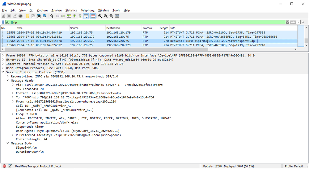

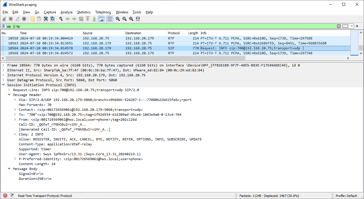

Frank.Schwarz Report post Posted 07/09/2024 02:34 PM Hello VoiceGuide Team, I can now establish a connection to the telephone system with the VG. The call is answered and a wave file is also played. However, no DTMF tones arrive at the VG. They can be seen in WireShark. Can you have a look? Attached is the logging. Thank you very much 2024-07-09_VG_Log.zip Share this post Link to post
SupportTeam Report post Posted 07/10/2024 08:46 AM Looks like this PBX (Swyx IpPbxSrv/13.31) right now transmits the DTMF events as 'INFO' messages. Please set it to use RFC2833 to send DTMF events. Also, please update system to latest version of VoiceGuide. We can only correctly interpret traces when the latest version of VoiceGuide is used. Share this post Link to post

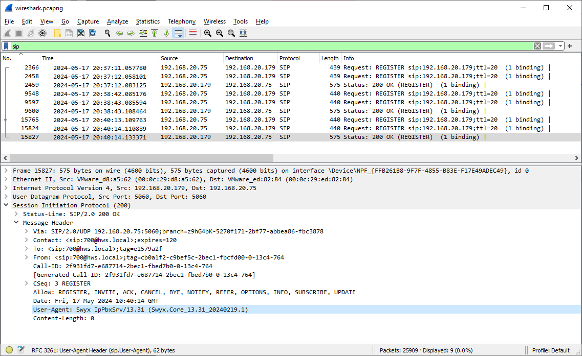

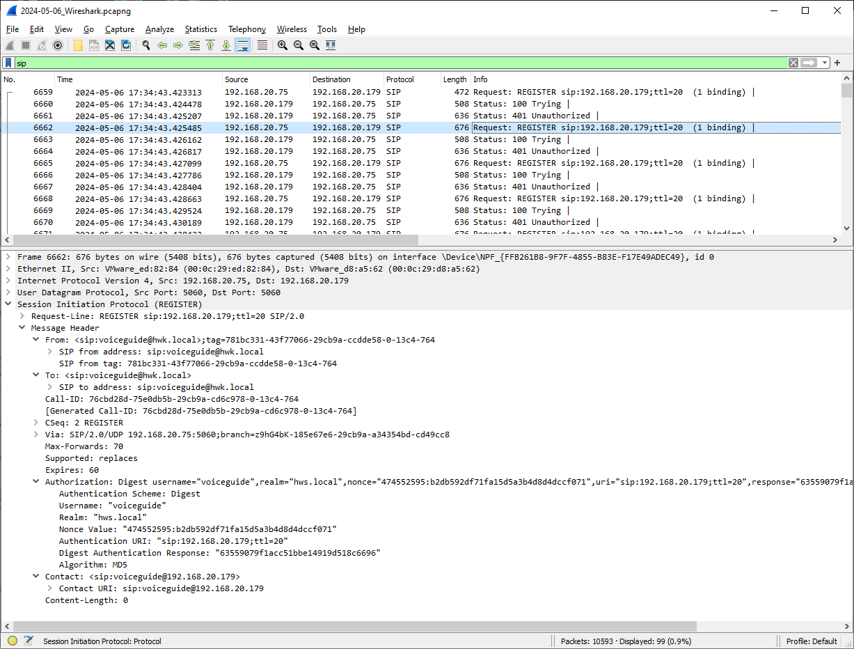

Frank.Schwarz Report post Posted 08/06/2024 01:29 PM Hello VoiceGuide Team, I have the following feedback from my customer: =============================== Hello Mr. Schwarz, We have received feedback from Swyx: For internal devices, DTMF is only transmitted via SIP info. Can this be activated in Voiceguide? Alternatively, I have just tried to register the SIP trunk directly in the IVR. I have the same issue as when registering with Swyx. The authentication is not transmitted correctly. Please find the Wireshark attached. Can you ask the manufacturer about this again? After the first login, the second one with the authentication header is missing. First login Voiceguide: See Picture 1 Nothing happens after that. If the trunk is registered on the Swyx, a second one with the Auth header is sent after the first Login See Picture 2 Also attached is the Wireshark log ============================== Thanks!!! Yours sincerely Frank 2024-08-06.zip Share this post Link to post
