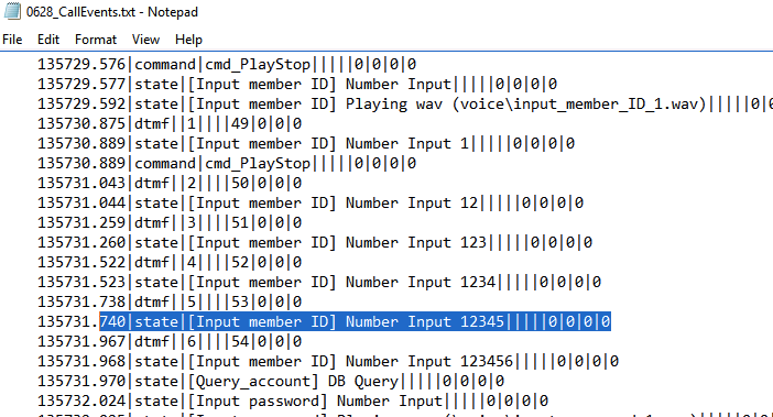

We notice that the log file of the voice guide has information about the user key input, like the capture of the sample file. However, due to security concern, we would like to hide those user input information, so is it possible to hide them in the log or encrypt the file/information?
