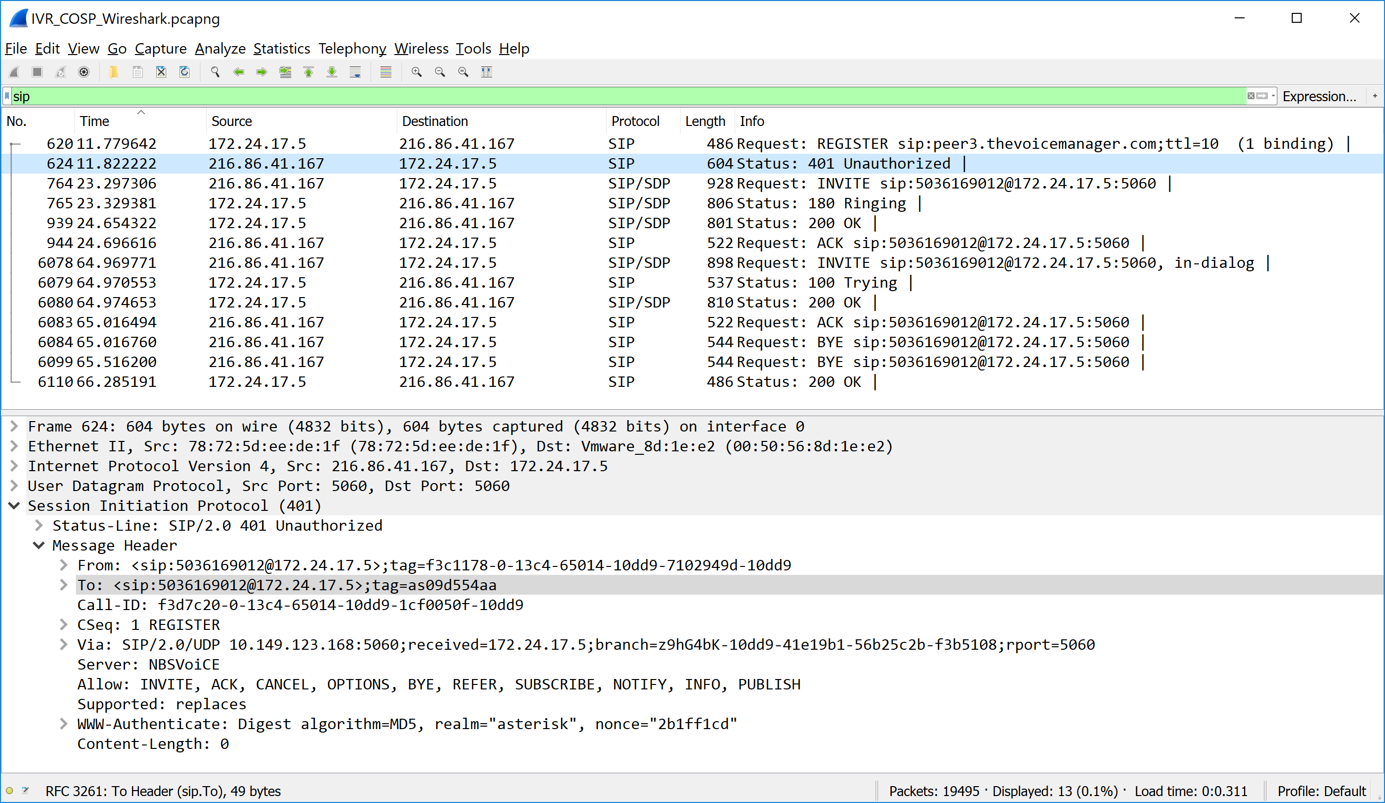

Please make a WireShark trace capturing the SIP REGISTER communications done at the VoiceGuide service startup time. Include at least one call in the trace. Keep the WireShark trace running for at least 3 minutes (until the SIP Registration expires and new calls stop being sent to VoiceGuide system). Once we have the WireShark trace we will then be able to advise how to set up the <VoIP_Registration> section of the Config.xml file.
Hello,
Attached is the wireshark capture that you have requested.  Also, we've included all other logs as well.
Please advise.
Thank you,
IVR_log2.zip
WireShark shows that the device at 216.86.41.167 (Asterisk PBX?)  immediately replied with a "410 Unauthorized".
So looks like the user/number 5036169012 / 5036169012@166.78.32.134 is not recognized by it. Maybe you should use 5036169012@216.86.41.167 ?
216.86.41.167 device logs may show more information as to why the REGISTER request was replied to with a "410 Unauthorized".
Also, VoiceGuide seems to be installed on IP address 172.24.17.5, so that IP address should be used in "Local Alias" (if IP address is used as part of alias).
Another option that you could look into is setting up a SIP trunk form Asterisk to VoiceGuide.
Another thing to note is that despite the Registration of 5036169012 not being made, the device at 216.86.41.167 does send a call to VoiceGuide (at IP address 172.24.17.5).
This suggests that there is already a route set up in 216.86.41.167 that sends certain calls to VoiceGuide.
If after a while those calls stop arriving at VoiceGuide then you may want look at the networking setup between 216.86.41.167 and 172.24.17.5
If you have any NAT type devices in the path it is possible that the original REGISTER request opens the connection between 172.24.17.5 and 216.86.41.167, and the connection is kept open as long as there is regular traffic between the two, but if for some time there are no packets sent from 172.24.17.5 to 216.86.41.167 then the address translation information in the NAT device expires and any packets from 216.86.41.167 will no longer be delivered to 172.24.17.5. In those cases having regular REGISTERs between the two devices maintains the address translations in any NATs in the path.
